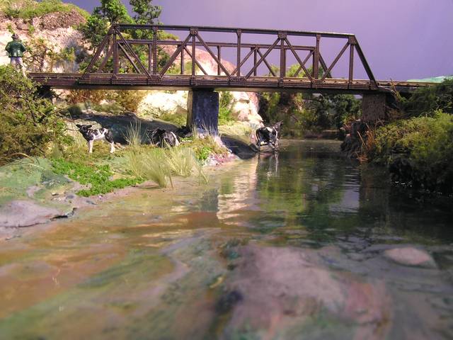

Looking for any advices on how to make water scenes look more real. Really looking for something between smooth surface and rapids. Open to all new ideas.

there are several methods for a ‘ripple’ effect which is what I think you are aiming for.
1: pour the water using epoxy or a similar product to obtain the smooth water, to achieve the ripples stipple on either ‘modgepodge’ or gloss medium, these dry crystal clear and the stippling leaves a ripple effect, you may need a couple of aplications for your desired effect. (both available at craft stores)
2: use a textured paint to cover the water area either stippling or with a roller to achieve a ripple effect. Paint the area to reflect water depth with shading, when dry cover with a high gloss polyeurathane or varnish for a wet look (waterbased will not yellow).
In both methods you can dry brush white onto the high spots to accentuate the ripples more. As always trial and error on a scrap piece is a good idea.
Hope these ideas help, I am sure you will get some more methods from others.

I think that envirotex makes a product that will simulate rapids… so you could use that, or probably even clear acrylic or something (gloss medium?)…
as for “smooth” water, any of the commercially available water products should be able to do that without any more work than “pour into riverbed & allow to cure”

When I did water having sealed and smoothed out the base I painted dark to light earth tones starting in the middle with black for deeper water.
I then gave the whole lot a coat of Tamiya clear blue once that was dry added an feature bits I wanted in the stream or river, I then slowly filled the water using gloss artists varnish a layer at a time leaving it a few days to dry a pin is handy to remove air bubbles.
Once you put enough layers in over a few pours the draw back is you have to wait a week at least sometimes longer for the whole lot to dry properly.
But the result is a nice water effect with ripples that will reflect the surroundings
A constant check must be made for bugs and these must be extracted from the varnish and a little more tipped in where the bug was extracted from and over the edges of the tacky hole so you don’t get unnatural edges.
Its time consuming but works well
regards John
You could use Acrylic Gloss Medium over top of Enviro-Tex:
Gloss Medium also works well over a painted base. It may take several coats to build up the desired shine and wave structure though. I’ve also had great sucess with a sealent called Lexel. Behind the dam is a painted base and gloss medium, while the water over the rocks and below the falls is Lexel.

You can make some rock outcrops with plaster or modelling clay before you pour the water. Also before pouring it you can include some logs, either leaning into the stream from the bank or farther out from it and breaking the surface from below. Sunken logs will look more believable in the varnish rather than added on as an afterthought.
You could paint your deepest parts dark green and your shallows creamy-grey, maybe. If the water is to be clean you can use a fine brush to outline some submerged rocks in the shallower parts. Try to avoid painting the entire outline or it could look overdone.
My only experience at modelling water is with high gloss polyurethane varnish, but I think all of the suggested materials can be worked to make ripples. I had to make mine several times as the varnish was setting. My river is probably too calm for your needs, but I could have put many more ripples in if I’d wanted to. If you want that flowing look be sure to add ripples around logs, rocks and bridge pylons, and probably some in the shallows. And make sure to put some rich green foliage close to the water.
