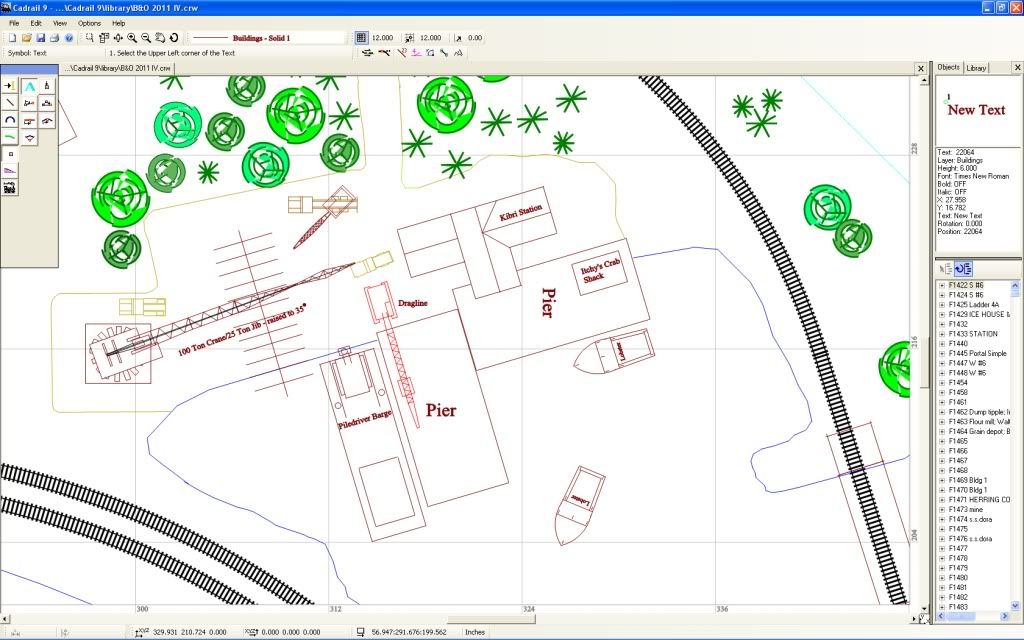

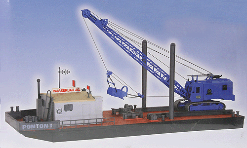

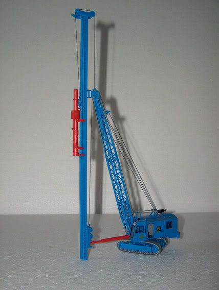

How would a tracked crane come off a barge? Planking? or use the 100 ton crane on shore - Want to do a scene where the piledriver and dragline could be swapped. and what size tug would be good? or did they use a push/pull boat in the '50’s - ish - Thanks Chris
If that’s the home base for the barge that carries those two vehicles it would probably have had a short, heavy drawbridge, something like the apron used to connect car floats to shore trackage.
Second choice would be the 100 ton fixed crane.
As for tugboats, the company might have had a small harbor or estuary tug on salt water, or a small towboat if the water is actually an inland river. Alternatively, they might have hired something like the old Revell (kit) tug from a local transportation company if they didn’t use the barge often enough to justify keeping their own dedicated tug.
Incidentally, a tugboat is shaped like a boat, and would usually move a barge by tying up alongside it. A towboat is shaped like a brick, with heavy pushing frames on the square bow, and ties up to the barge end-to-end.

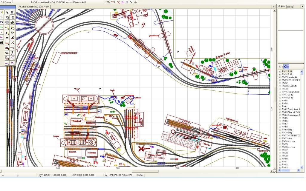

The “river” dumps into my “harbor” after the swing-bridge(top middle)- The tugs/floats and ships are moveable .

Thanks - I think the two (telephone pole looking) posts are suppose to drop down to stabilize the barge, and I have an atlas girder bridge laying around…If I park close to shore, (drop) the poles and bash the bridge to the proper size, I could use the 100 ton crane to position the bridge from shore onto the (wood) deck on the barge(with scale pins/bolts to hold them together) for loading/unloading…not going to be permanent - would like to move barge as needed…
