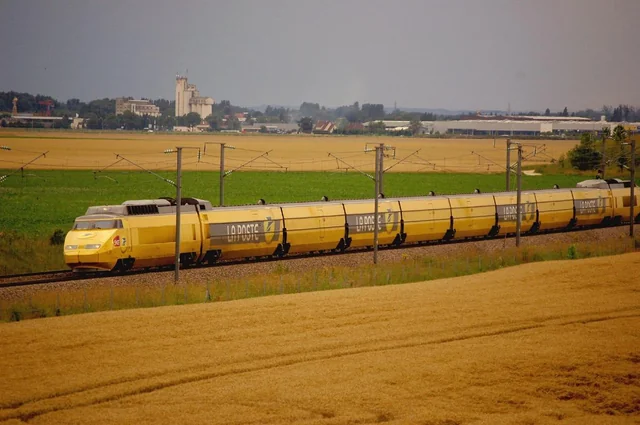

The French are probably a better model; they had dedicated M&E TGVs (and that is probably the only ‘niche’ of bulk freight that would be profitable to run at high speed in suitable LGV).

Bullet trains are so fast in fact, that the doors seal the cabin from the atmosphere, so having a dedicated set or cars like the TGV would be important
