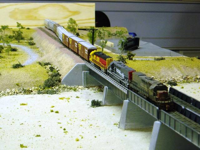

Here’s some results for you,
This photo shows the embankment with the main color and the riverbed with a lighter color mixed in. I may darken the riverbed just a little. I also knocked off the larger bits of sand as it dried so it looked more smooth, like a dry river bed looks.
Colton_Proto_module_064

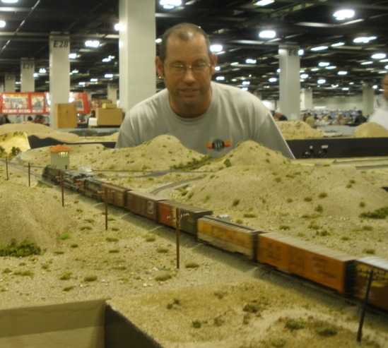

Now here is our base latex color with play sand pressed into it. the secret is in the base latex color. This modeler did use some of the grout to.
IP_Anahiem_2010
This module has many different grout colors. the dirt road was made buy simply wiping off(or knocking off) the high sand granules and adding a slightly lighter color of grout than the surrounding area.
modules_003
