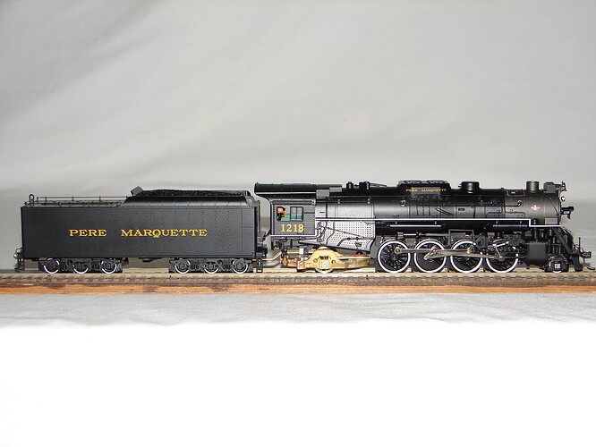

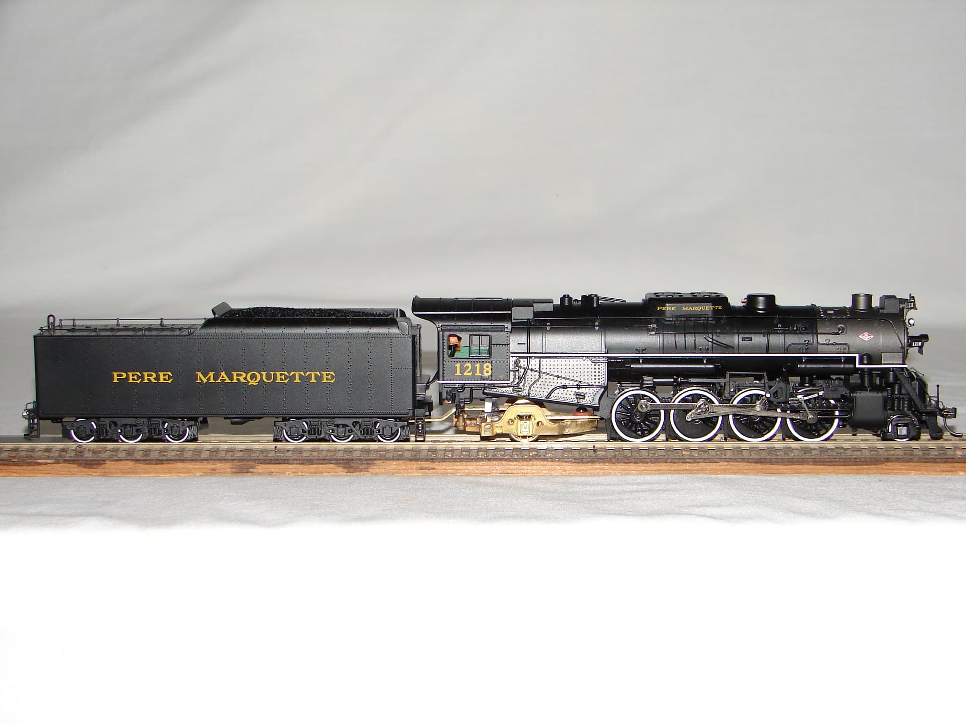

Bachmann put the wrong trailing truck on the 4501.
Yes, not sure how they messed that up considering they have the right part.
At least it is an easy fix, that trailing truck is the same as several other Bachmann locos. I have spares if anyone needs them.

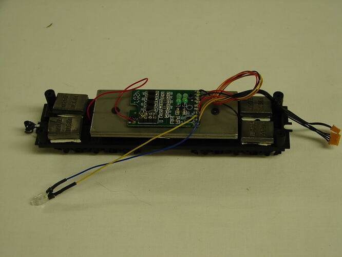

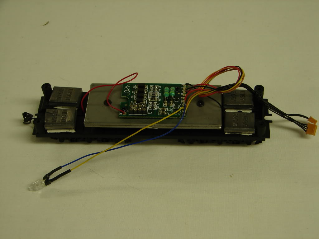

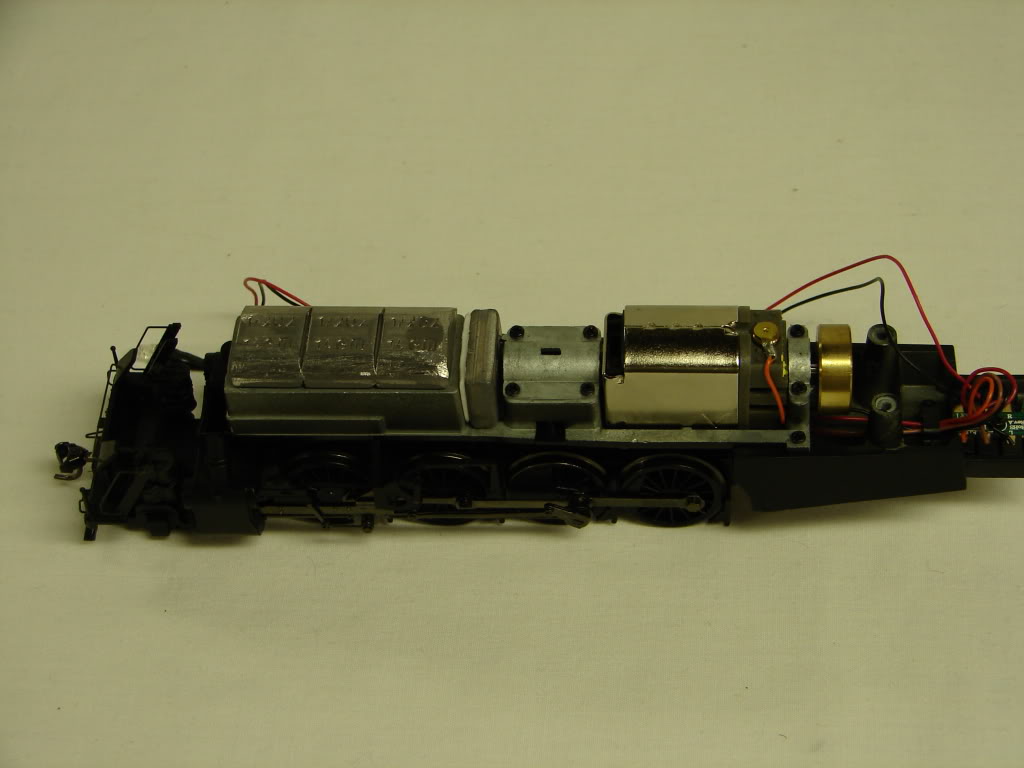

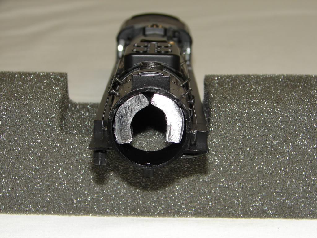

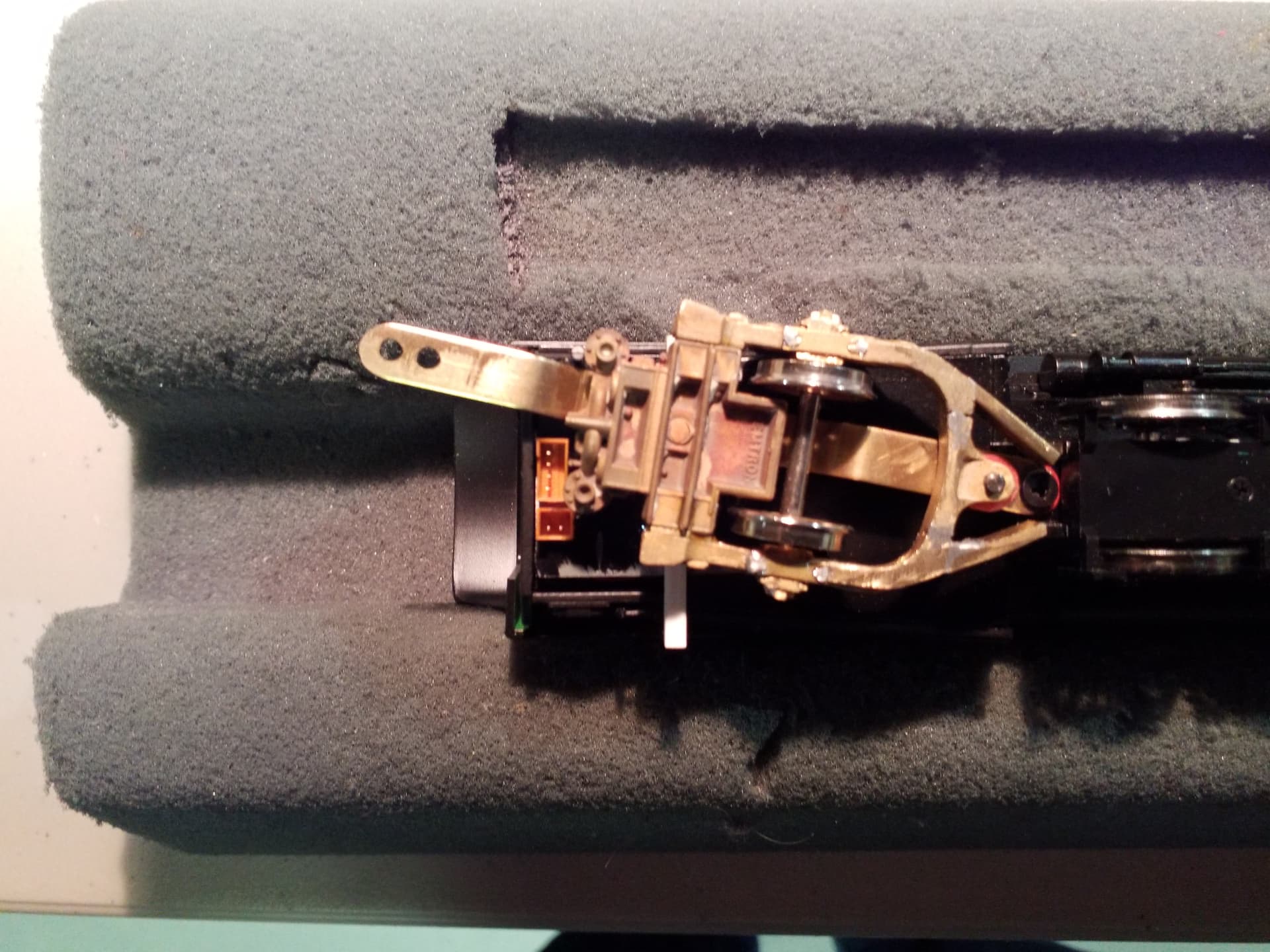

It has a simple straight forward drive that works fine. It has two weaknesses, we will take them one at a time. The first one is weight, it is too light. This obviously effects pulling power and tracking.
So add weight, it’s easy to do. Here are some photos.
I also added some weight inside the fire box, can’t seem to find a picture of that, at least two of these stick on weights back there as well.
And I always add weight to most steam tenders. A better tracking tender has better electrical pickup.

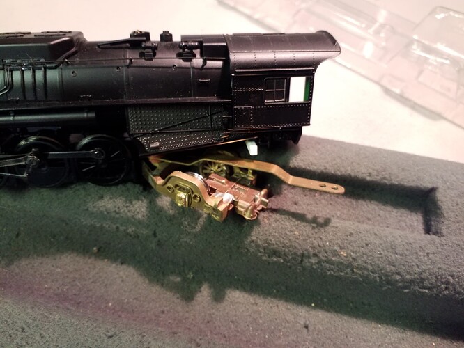

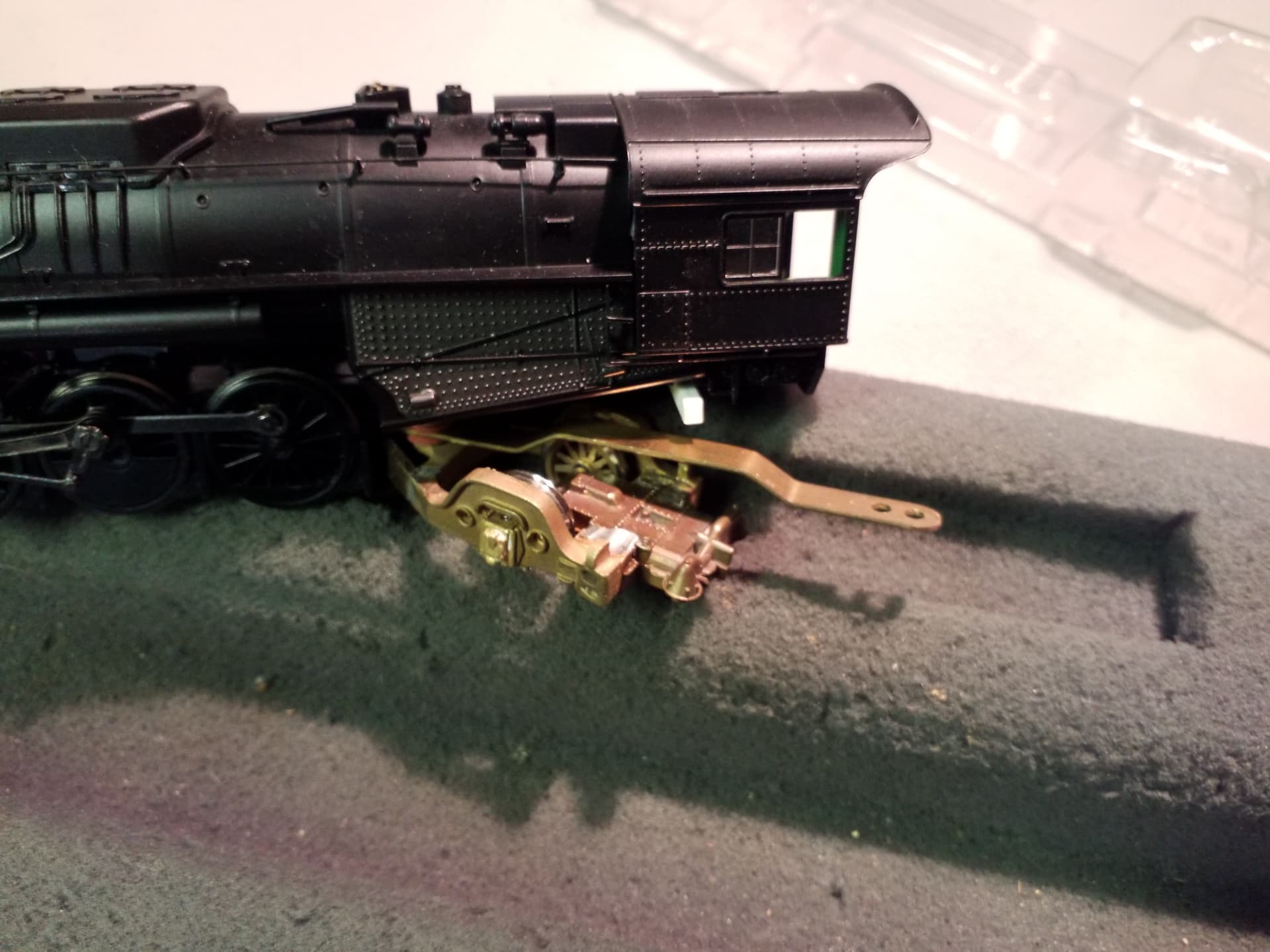

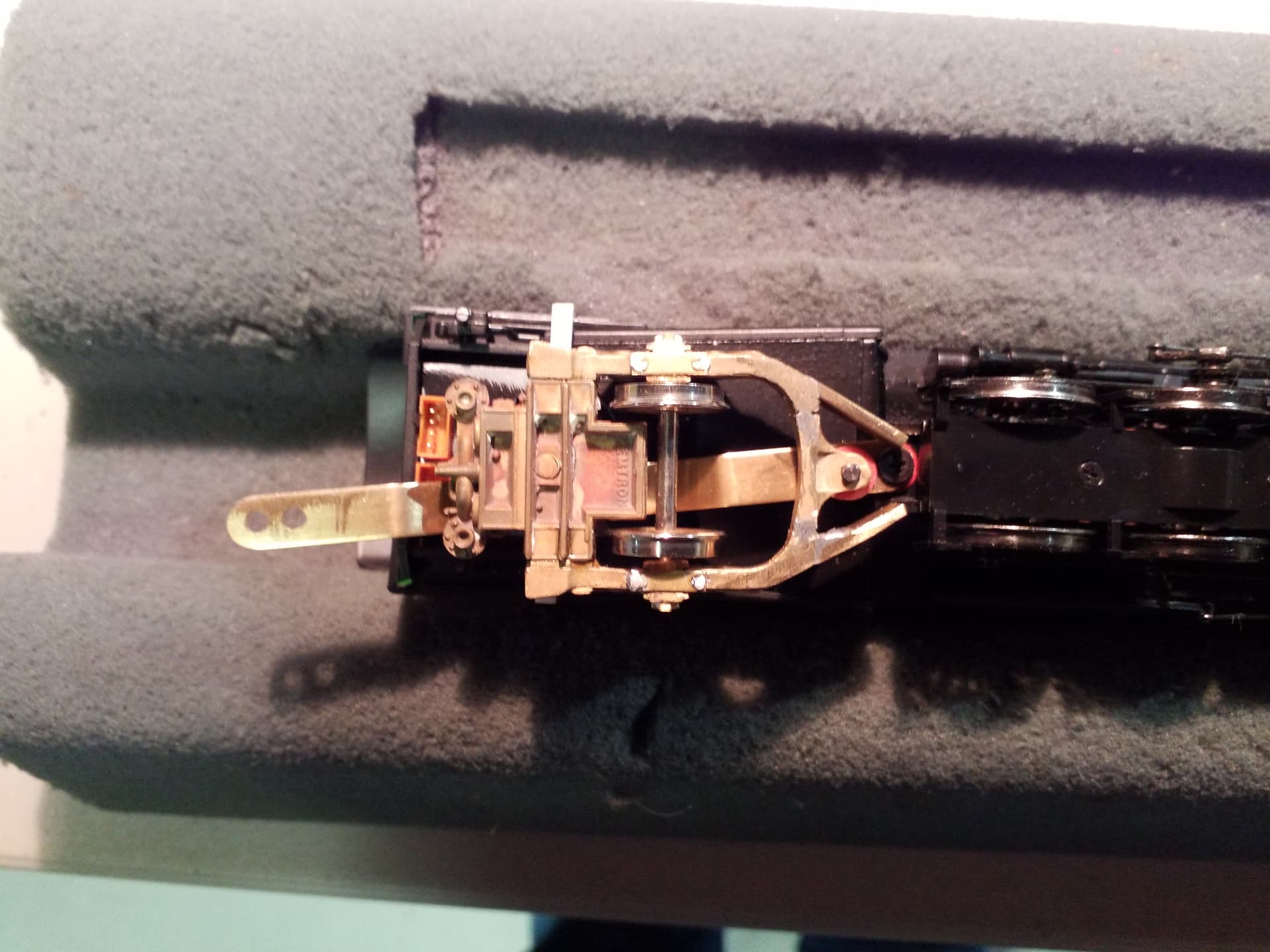

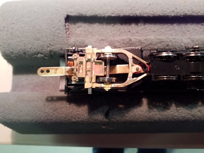

The second shortcoming of the Berk is the drawbar, it pulls the loco sideways on even moderate sizes curves. So cut the drawbar pin off the locomotive, and make a drawbar that connects to the trailing truck mounting location.
I converted my locos to freelanced Mikados, but you can do this with the stock trailing truck as well.
This will change the pulling dynamics of the loco and greatly improve how it tracks around curves.

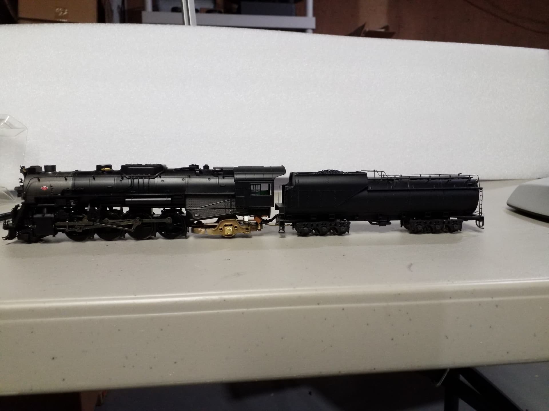

And here is one of my other versions of the Berk converted to a modern heavy Mikado.
Sheldon
