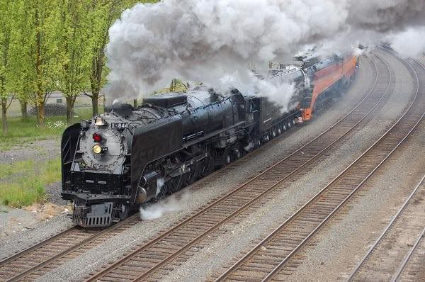

Thanks for being patient and answering my questions, And as a thanks here is one of my Pic’s of the 4449[:D]

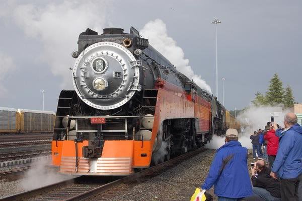

Since we’re sharing photos of #4449 here are a few if mine[:)].

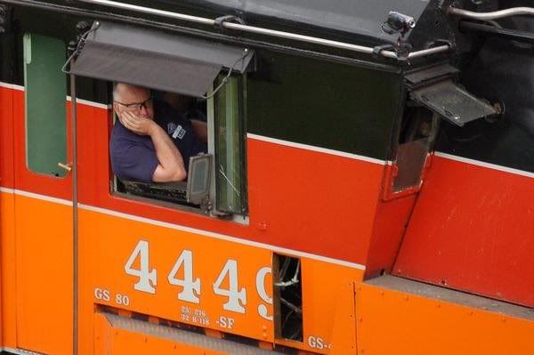

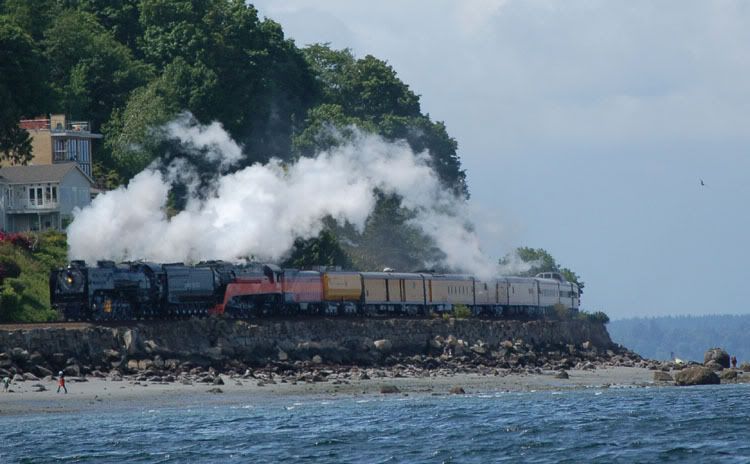

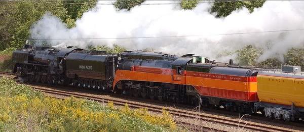

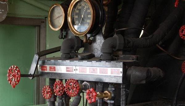

Here are some pic’s I was able to dig up of my trip with the 844 and 4449. My hard-drive died on my com and lost almost all of that trip’s pic’s [:(] this is all that is left.
If you did not know any better he was not having fun.
