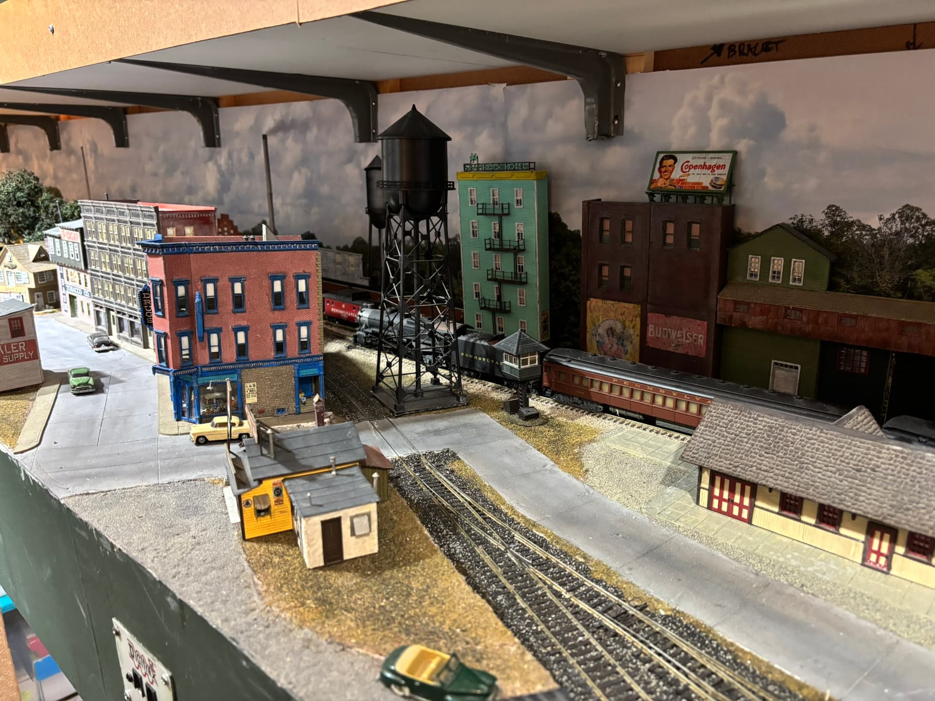

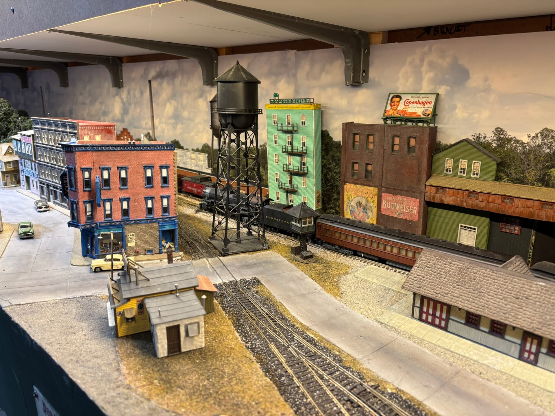

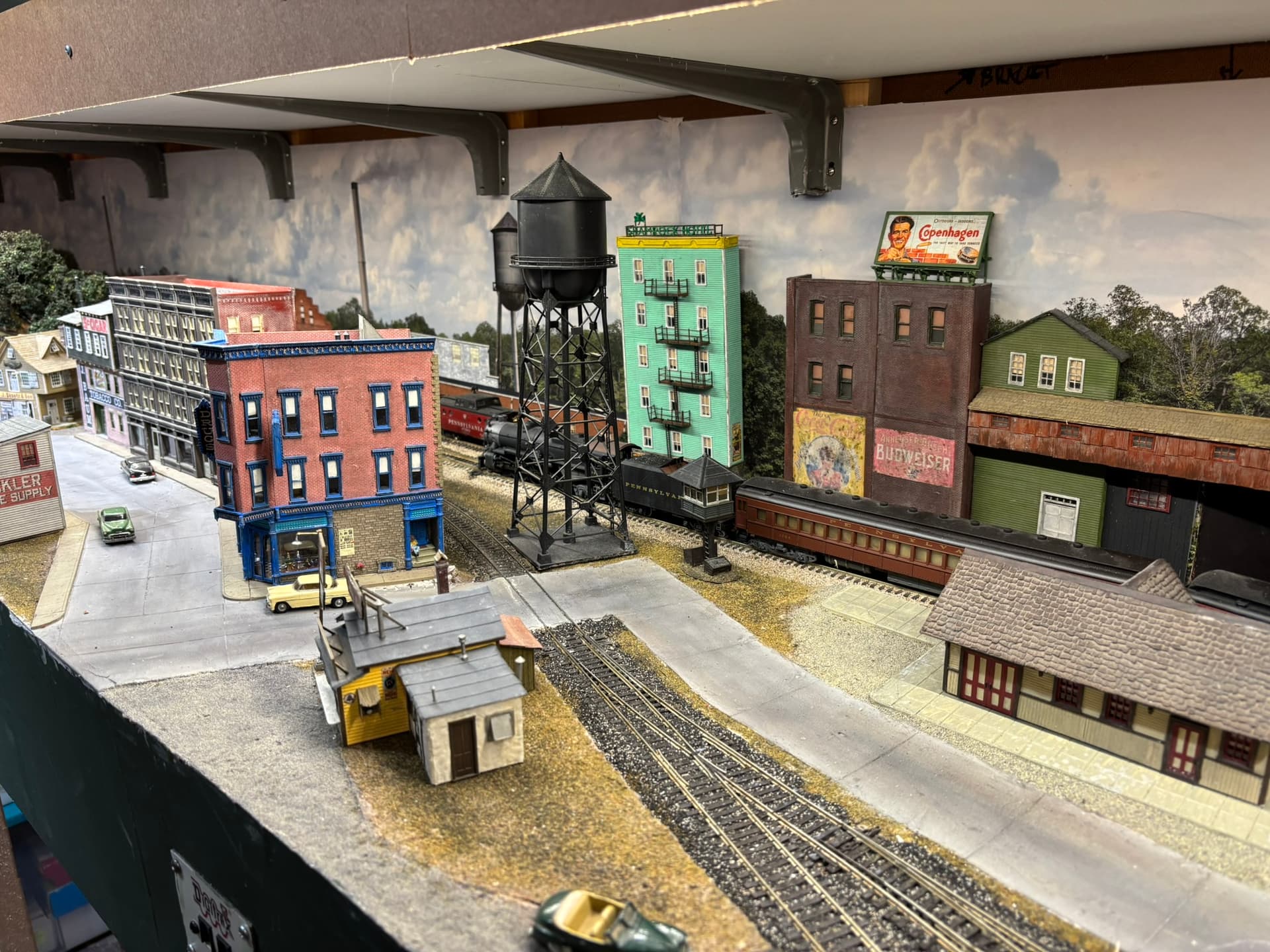

I recently reached the second level of the layout and installed a single light strip on the underside (since the first level was now in shadow of the track lighting). I was amazed at how easy to install, and effective, this was.
No light lower level:
Lights on (“neutral”):

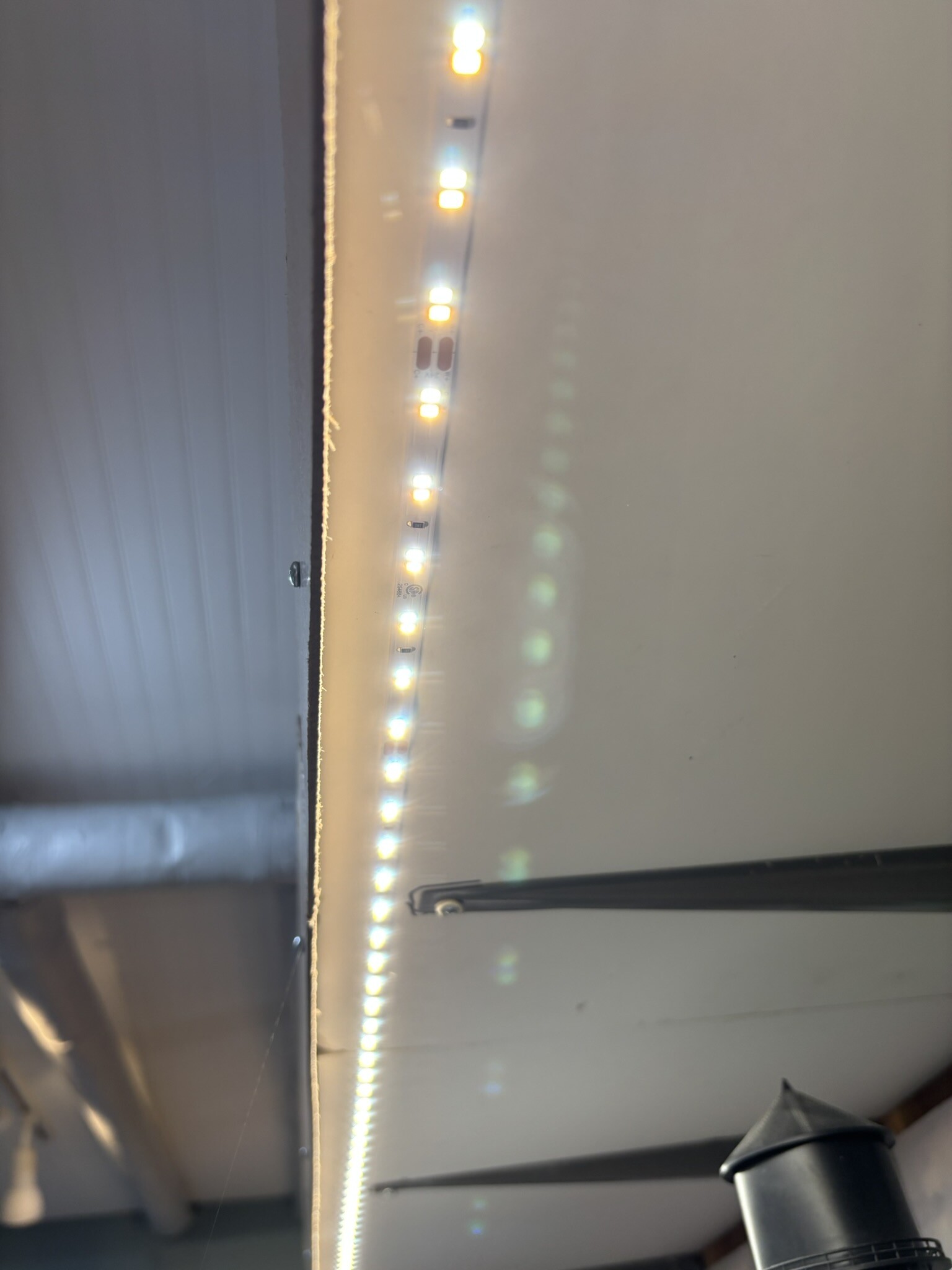

One of the advantages of the LED strips is that you can get with adjustable “temperature” settings. This is the “warm” setting (my preference) on lighting:
LED installation, easy peazy:

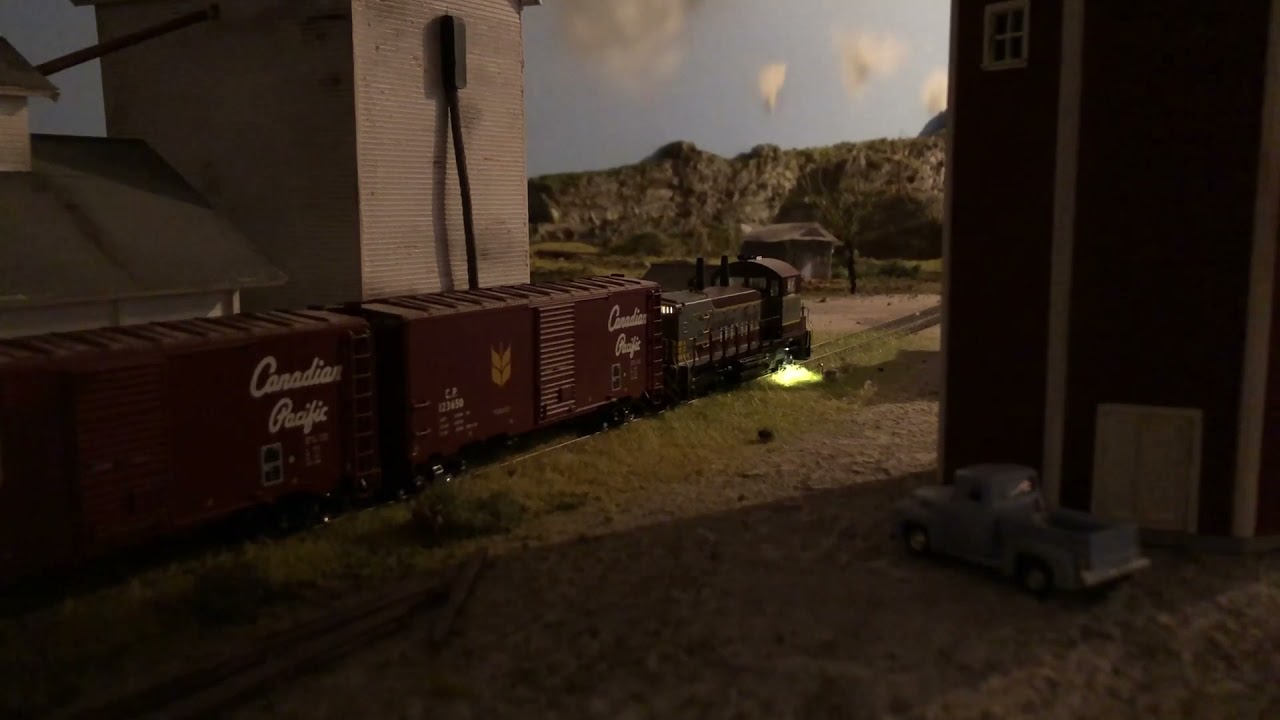

I agree with greg about being able to cast shadows for effect so I put it on a dimmer which gives me good late in the day shots like in this video.

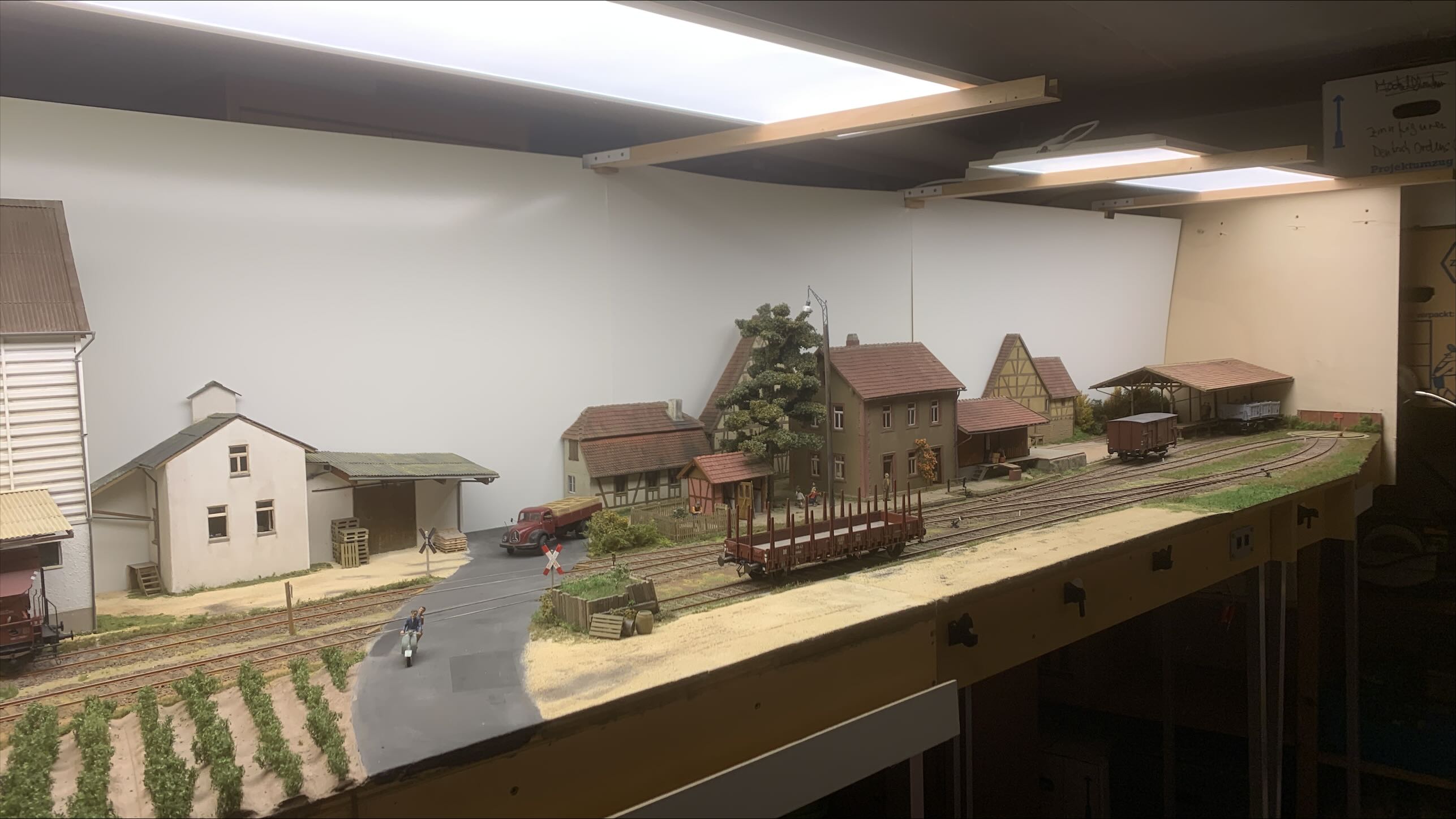

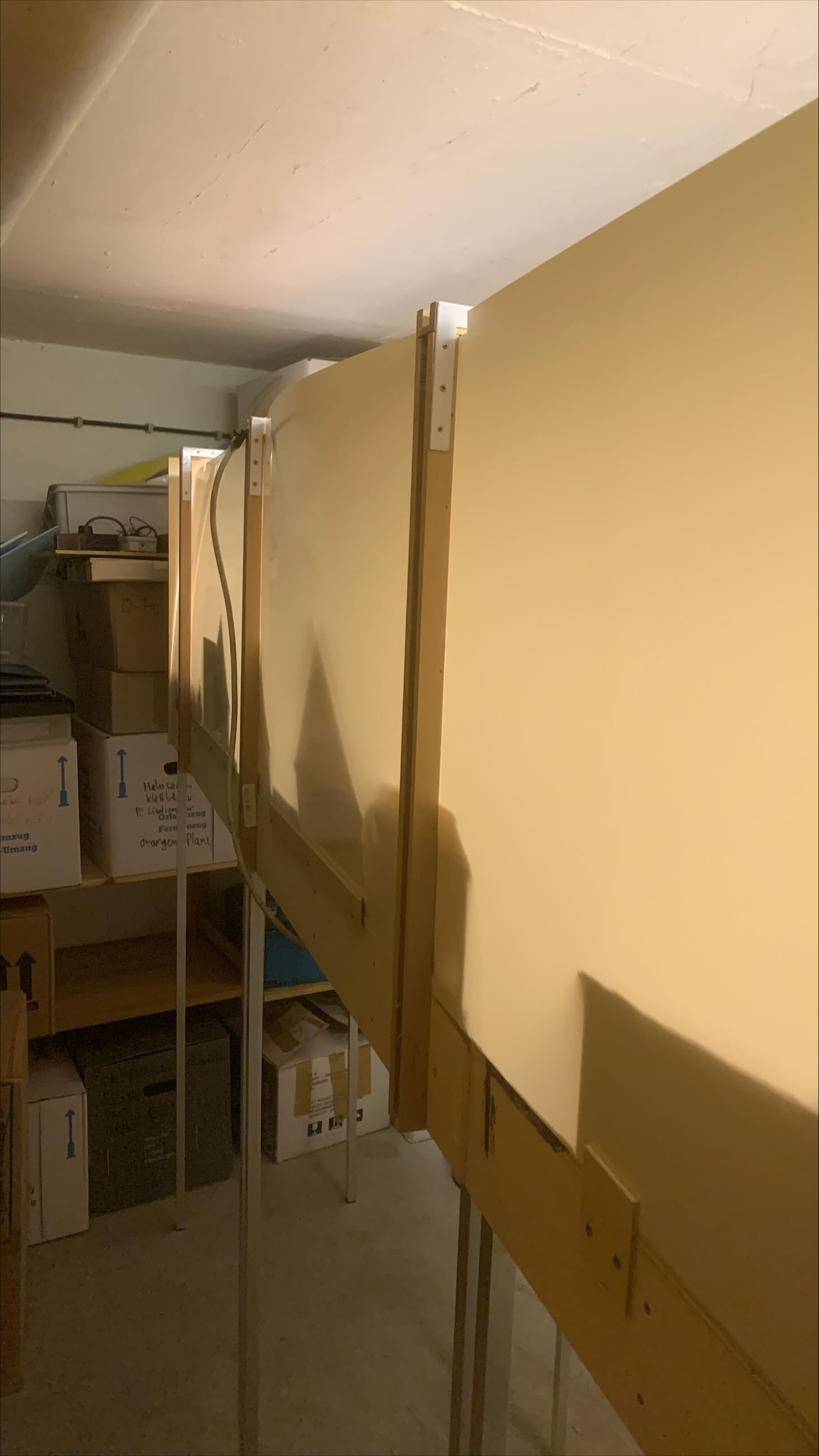

A couple of years ago, I started a switching layout, having the notorious light in the centre of the ceiling I designed supports for the LED-lights.
The layout is 9 x2 feet in dimension

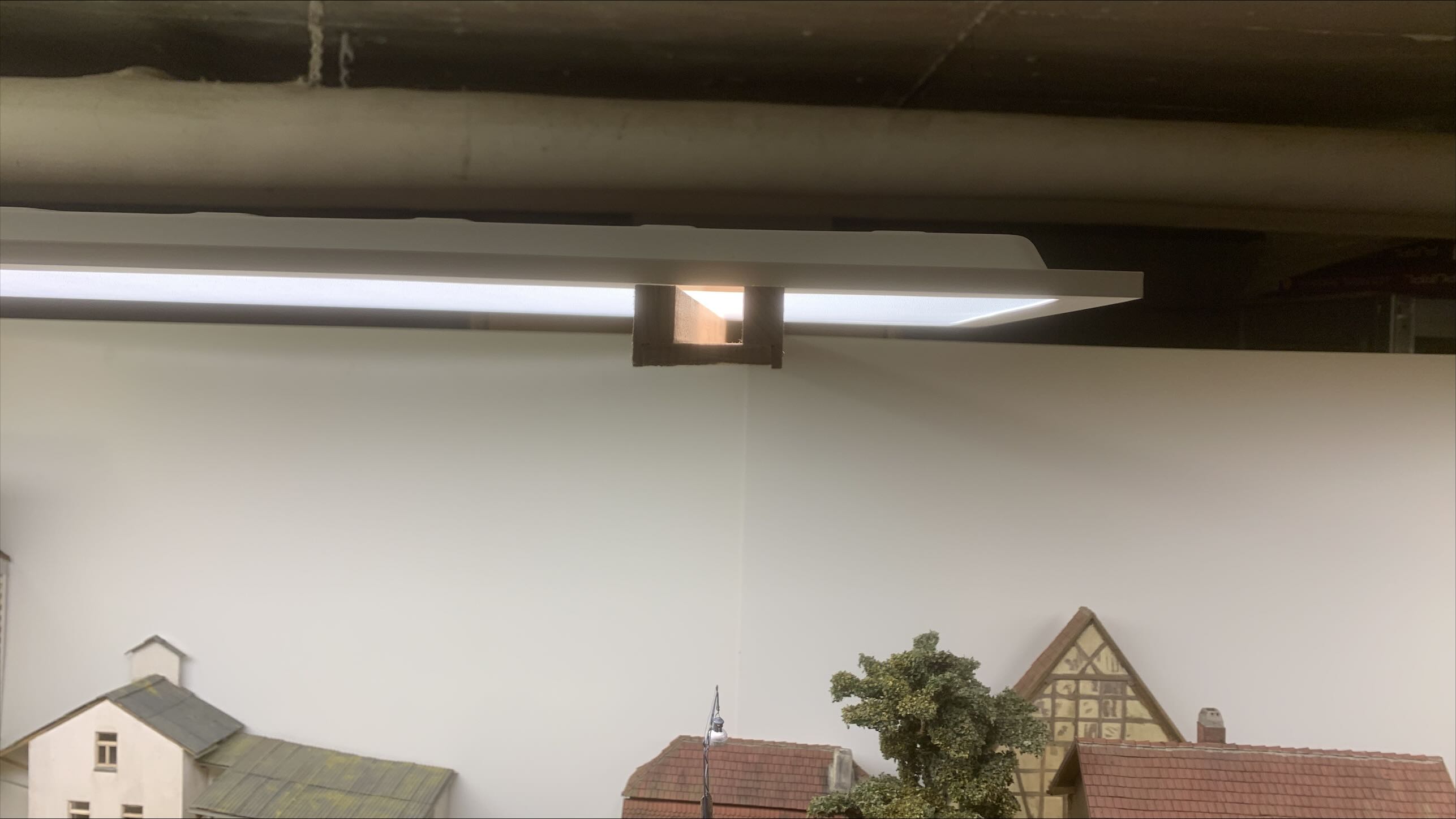

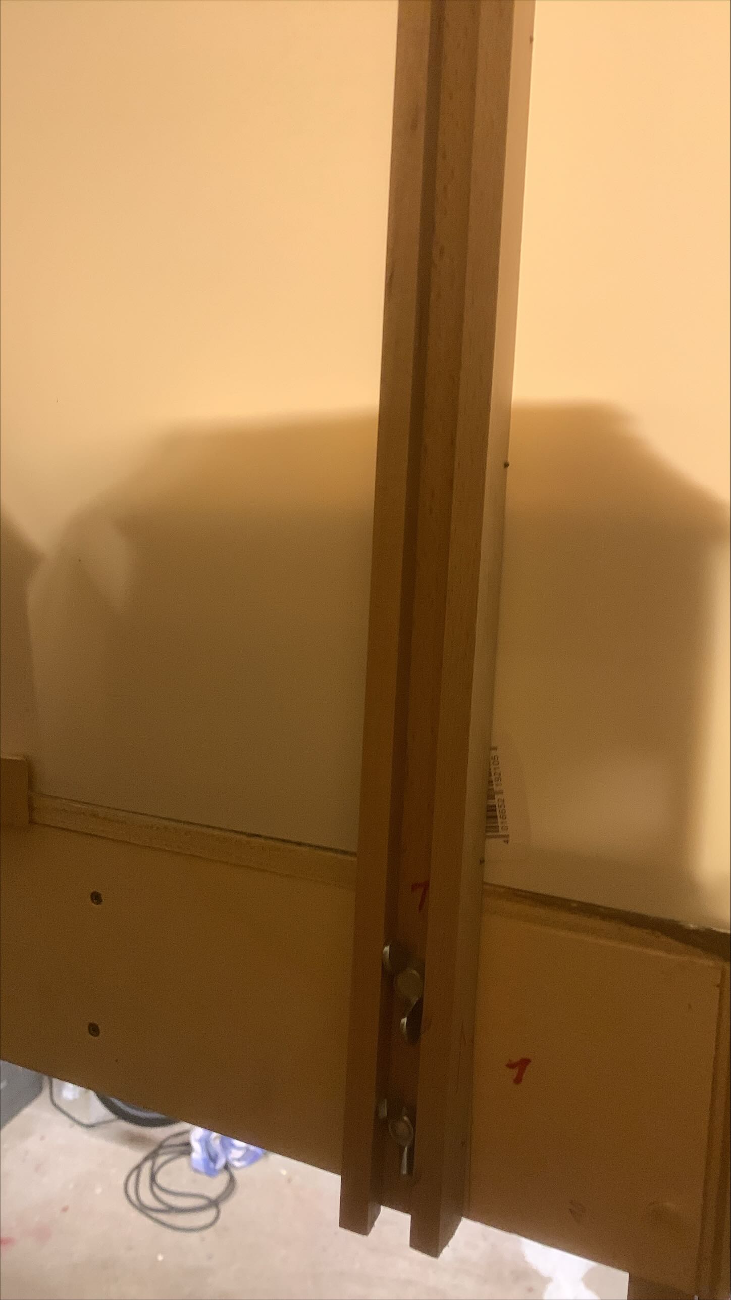

I used 3x5 mm hard wood, glued and nailed the strips to form a U.
I use screws to fix it to the layout.
So I can fix the backdrop, which is 1 mm polystyrol board.
The lights are good to have. What is still missing is the screen / fascia (what do you calle it? sorry) so you do not have to see into the lights directly.
Having moved house, the small layout does not fit my room. So it is in the basement waiting for the exhibition in November.
It was quite a job, but I like my design. The U-channel wil make it possible to clip in the board.

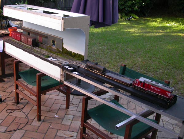

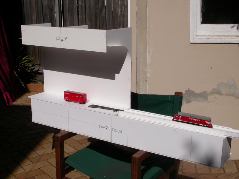

I saw this somewhere, its a back drop with a valence (light box) attached to the top. Its not my idea but looked good with options for what lights you use.
