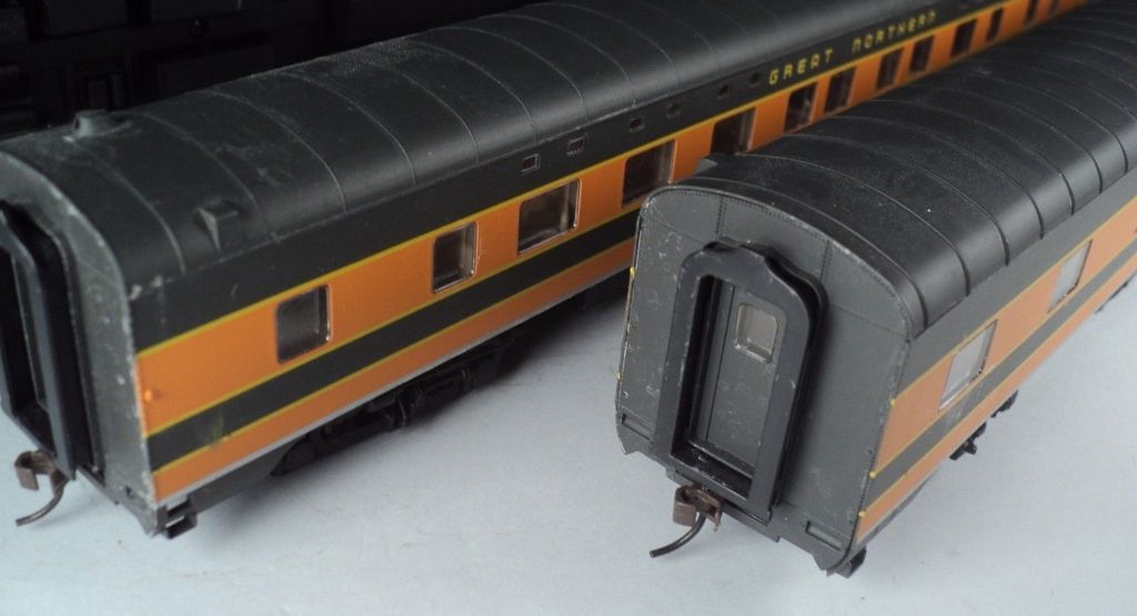

To confirm, the RPO is Rivarossi/Hornby, also sold in Walthers labeling for a while. I have one just like it, in a Walthers box.
The second car, as Dr Wayne said, is old Rivarossi, likely 1970’s production, with the original truck mounted couplers replaced with body mounts.
Sheldon
THIS was my little clue that it might be Rivarossi:
Quite obvious is the similarity to the Walthers passenger car coupler arrangement which leads me to believe that the Walthers production is handled by Hornby.
I bought the cars from MB Klein and they were listed under Rivarossi as the manufacturer.
Happy New Year!
Ed
Ed, since their inception, those cars have been marketed in a number of different packages. In fact, at the time I bought mine, some years ago, Walthers had the 4 car sets in Rivarossi packaging, and the individuals in Walthers packaging…the cars in Walthers packaging have no brand markings, but are otherwise identical to the Rivarossi cars.
Walthers became the primary importer of Rivarossi after AHM, so it would seem logical that Rivarossi/Hornby is involved in all or some Wathers branded passenger car production.
Keep this in mind, Hornby has moved actual production to China like most everyone. It is possible that Wathers has contracted Rivarossi/Hornby to do the tooling but actual production is done directly for Walthers, but in the same factory Rivarossi/Hornby uses in China.
When LifeLike first developed the Proto line, the tooling was done by Brawa in Germany, then sent to China for production. As part of the deal, Brawa retained marketing rights of those products in Europe, and sold some Proto items in Europe under their name. And the later Proto steam locos were done in conjunction with ROCO and marketed byu them in other countries with their name…
No different than all those Whirlpool refrigerators that say Kenmore, Kitchen Aid, etc.
Sheldon

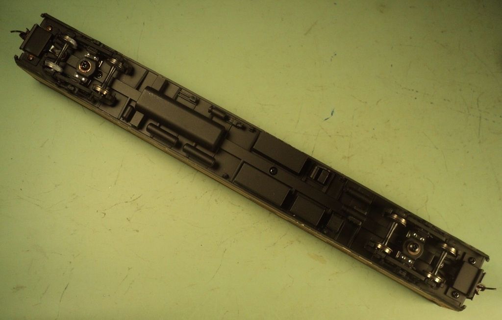

Gotta love those web forums! Fascinating exposition from everyone, thanks very much. So, it sounds like a car can simultaneously be a Walthers, a Hornby, and a Rivarossi, depending on how you look at it. Is it safe to say, the two-screw knuckle couplers are distinctly a Walthers element, or unique to this Walthers/Hornby/Rivarossi production run? The quality of the coupler looks pretty good, in any case.
Is there anything I should look out for in terms of some knuckle couplers not playing nice with others? I assume that knuckles are supposed to couple to each other across brands, but I also assume that doesn’t always work out in reality…
Last thing, can anyone post a picture of the underside (esp. couplers) of a typical Branchline, Walthers Proto, MTH, and Rapido passenger car, so I (we) can have a good reference for what they look like? (Thanks Dr. Wayne for the nice underside shots… Do any “of-the-shelf” cars have that level of detail underneath? Is it safe to say all prototype cars have that much stuff underneath?!)

I am highjacking the thread briefly to note my continuing awe at what Wayne can do, and routinely does, with commercial – and not the high end stuff, either – model railroad rolling stock.
To respond to Mac’s inquiry, that is, do any 'off the shelf" model trains have the level of detail like what Wayne has shown us, I’d venture to say that perhaps Rapido, and perhaps the old Branchline kits if built to their fullest potential. There might even be some modern era imported brass that goes that far although I can tell you that the older imported brass passenger cars such as Soho did not even come close.
Most of us mere mortals are quite satisfied with the approximations of completeness that the commercial models provide us with, particularly if we have already paid a pretty penny for those trains and just want to run them. Wayne makes silk purses out of sow’s ears, and indeed lavishes his talents and attention on models that in some cases barely rise to the level of sow’s ears.

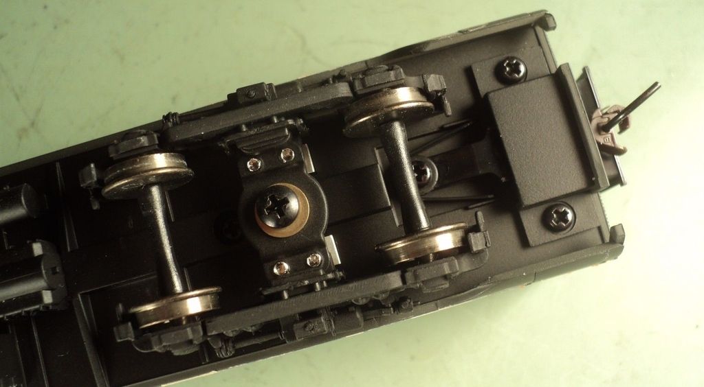

Okay, so here’s another mystery car, no road number, just a Great Northern smooth-side passenger car, metal wheels, plastic axles, with interiors. It looks a bit like the long shank coupler Texas_Zephyr described on Broadway Limited cars, but it doesn’t look like the coupler would extend particularly…
Any ideas? Thanks!
Mac
One look at the trucks and couplers, no question - Wathers.
The design of the trucks is unique to them.
And, respectfully, I don’t know where you are getting this stuff, or what you are paying, but the general cosmentic condition I see in the photos would cause me to walk right past…but that’s me, I do not buy stuff “already been played with”, expecially if it looks already been played with hard…
Sheldon
