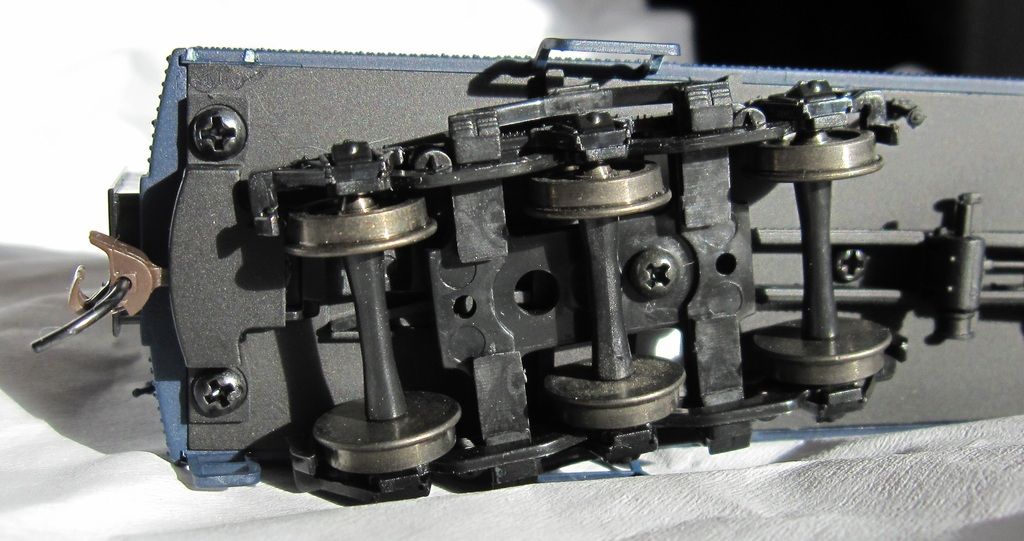

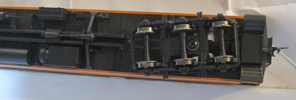

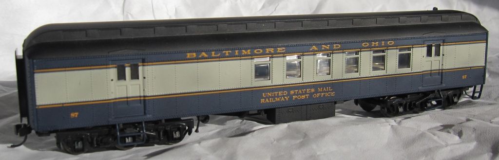

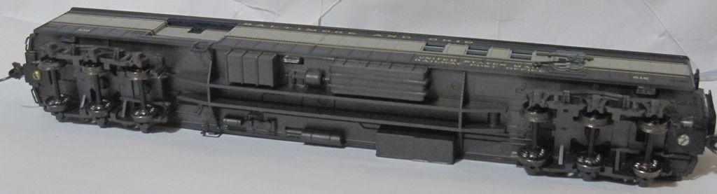

Okay, so here are the two mystery cars, with a couple of pics of Walthers and Bachmann “bottoms” for comparison:
Any thoughts? There is a Walthers “Trainline” ROP #87, but I couldn’t find photos. (There is also some other ones, I believe).

The RPO was made by Rivarossi. They are manufactured by Hornby but have recently began marketing under their own name again.
http://www.hornby.com/us-en/shop/brands/rivarossi.html
I have a few of the baggage and RPO cars but, to me, the coach and combine are a bit short at a scale 60’ although good for a “kitbash project”.
Good Luck, Ed
Mystery 87 may be the Hornby version of the Rivarossi RPO, but it’s definitely not the older Rivarossi version: note the separately-applied axle-powered generator and the truck and coupler mounting shown in the second photo.
Mystery 516, however, is an older Rivarossi car, likely with replacement wheels from either Kadee or Proto.

Yes, the RPO is Walthers Trainline. Originally that series included a coach, combine, baggage, and RPO car in several different road names. The prototypes were supposed to be C&NW but I don’t know whether all the models were quite accurate. I recall an item in the B&O Historical Society’s magazine, the Sentinel, that said the B&O version is very close to an actual B&O car.
I think the coach and combine were reissued a few years ago, but the other cars haven’t been made in some time and are in some demand.
