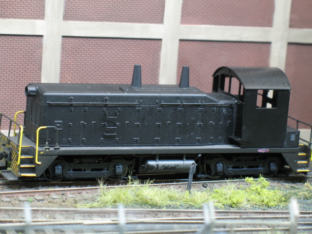

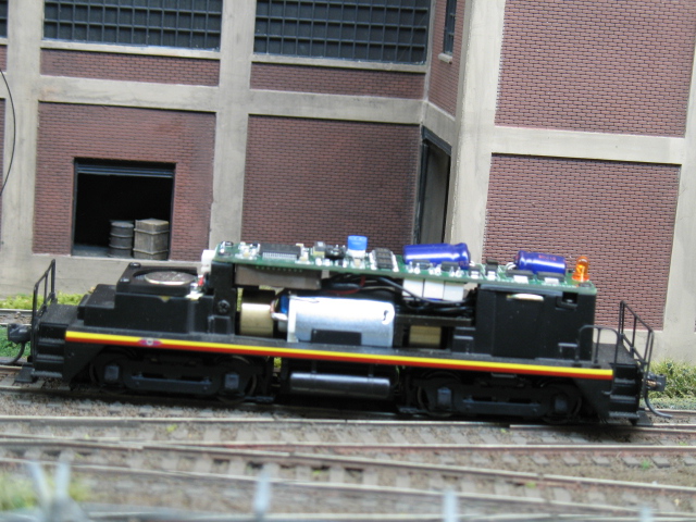

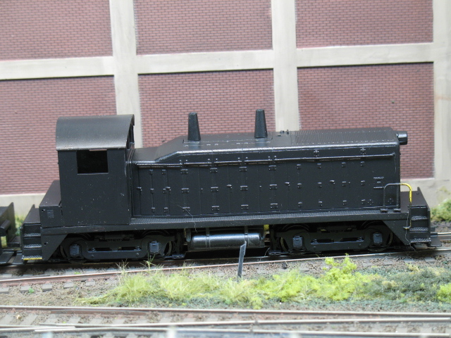

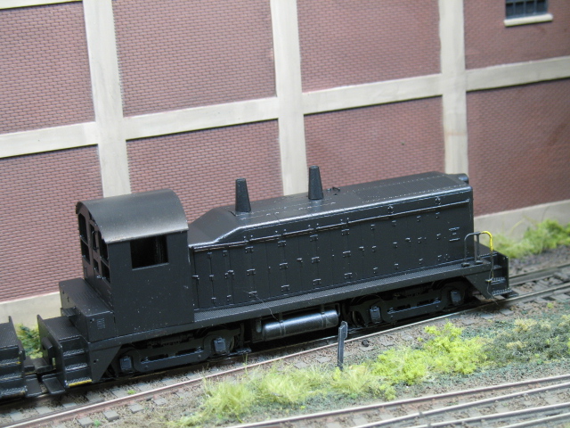

While I was looking for these locos I found an old Kato NW2 that I’d put away, as I couldn’t fathom out how to soundchip it, due to the rather large weight inside.
Now, fortune favours the bold, so instead of hacking away at the chassis block, I took a spare SW7 chassis (with twin speakers),
filed a few bits off the chassis, cut and filed several bits off the inside of the NW2 shell, and hey presto…
A Kato NW2 with sound
Now to get stripping and painting.
Jon

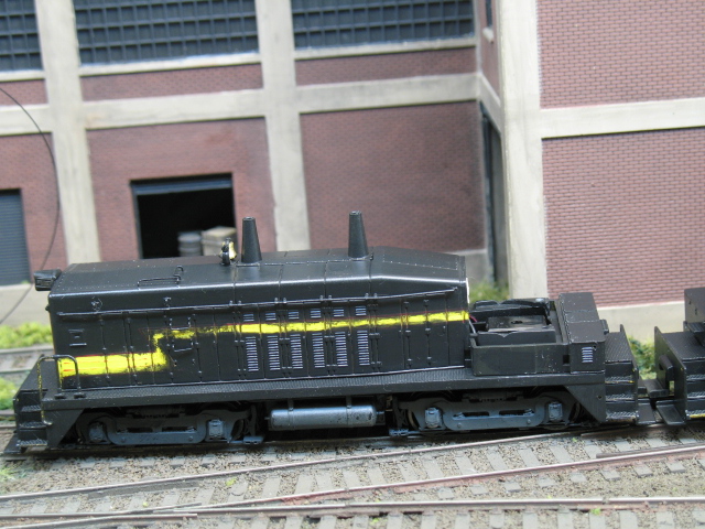

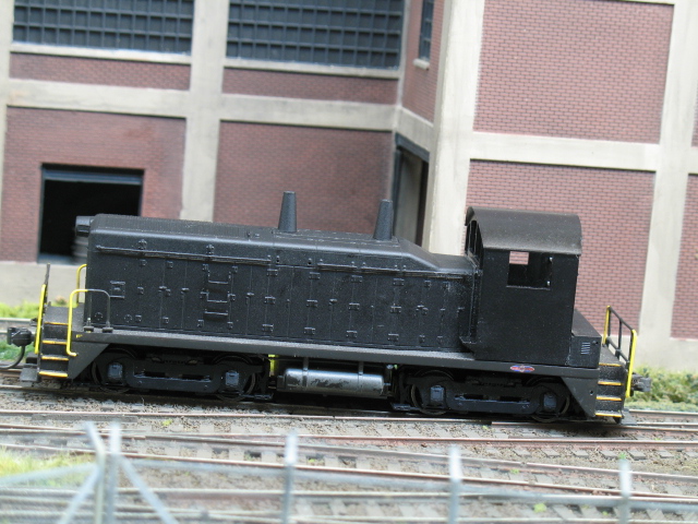

Dark green (and cat hair) applied. I now have to wait 24 hours for the paint to dry before applying any decals.
Jon
Jon,
Way to go on the creativity scale!
Curious: Is the spare chassis BLI or was it another brand?
If another brand, what type of speakers did you use and what are their ratings? Did you install a Soundtraxx decoder?
The chassis I used to mount the NW2 shell was from a CBQ SW7 - BLI with 2 speakers. I intend lengthening the wires on the cab-end speaker and mounting it in a stealth/silent SW7 and run them as a pair -2 for the price of one.

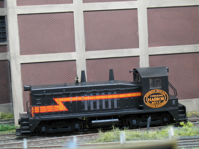

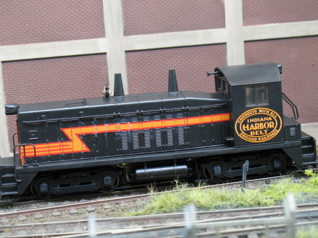

Started adding Microscale decals to the switchers tonight
Jon

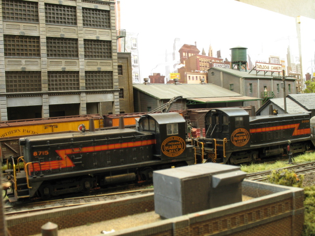

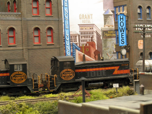

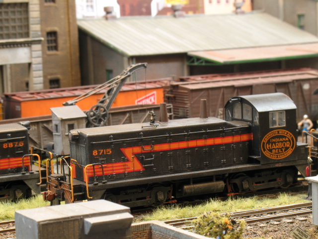

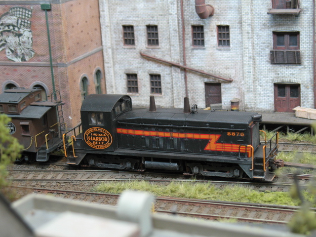

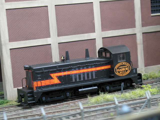

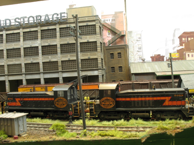

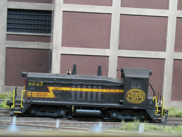

I finished off the three IHB switchers last night and gave them a road test to check the sound and directional lighting.
Jon

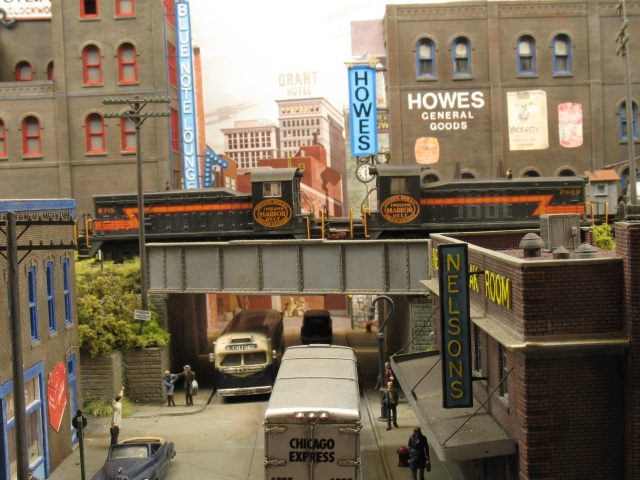

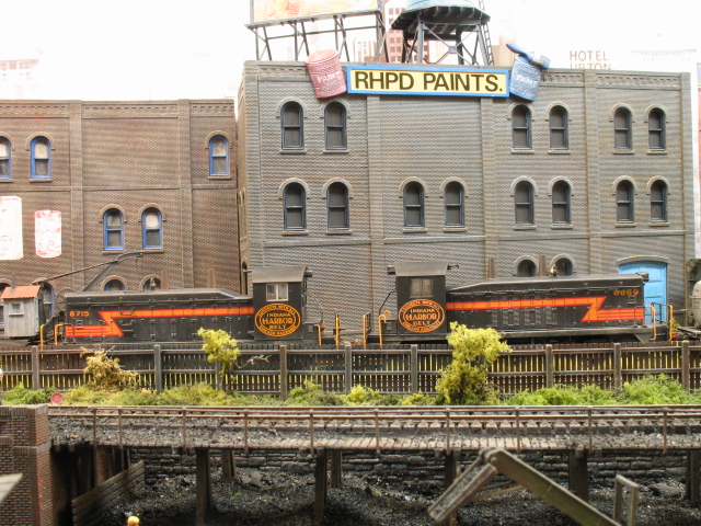

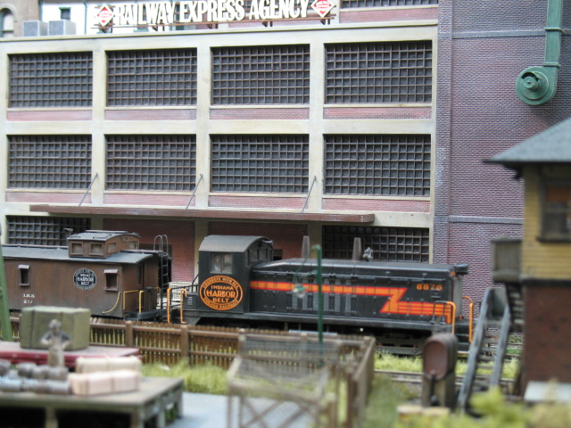

A few more photos and, as ever, the accompanying video clip.
