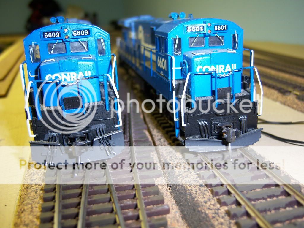

Okay, since there is a little show and tell, a couple poor photo examples.
Atlas C30-7 with DW 155 plow on left, and DW weed cutter plow on right. I use the Wither’s Conrail Motive Power Guide as reference. There is a photo in that book showing this loco w/weed cutter:

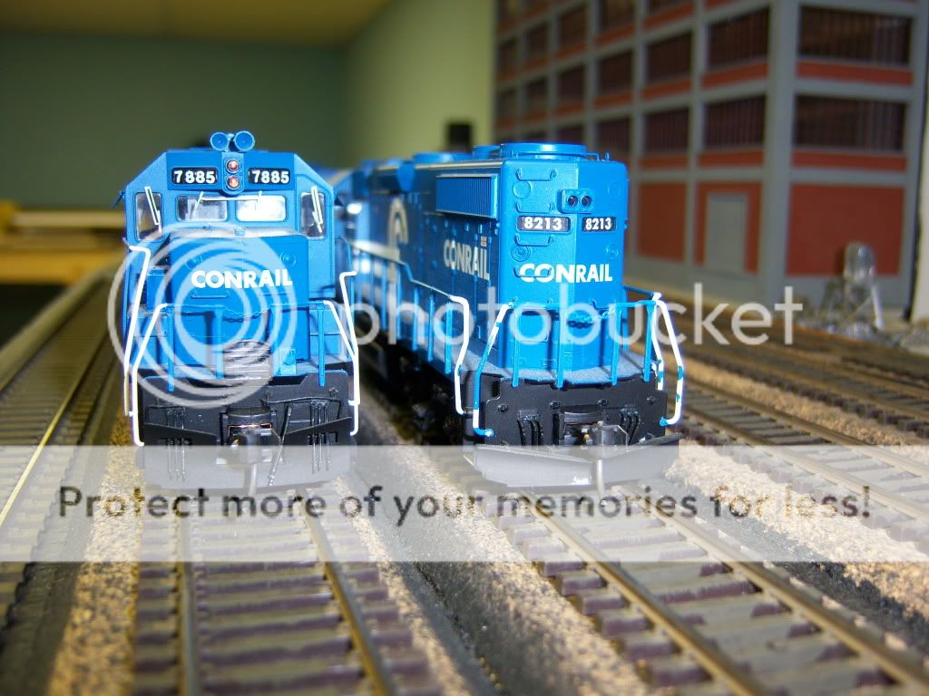

Atlas GP38 with Atlas supplied plow on left, and Atlas TrainMan GP38-2 with DW weed cutter plow mounted on rear pilot. Some Conrail units had standard plows on front w/weed cutter on rear:
maxman - there’s nothing wrong with those locos/plows/mu hoses.
LOL I was actually referring to the photos, but thank you.
