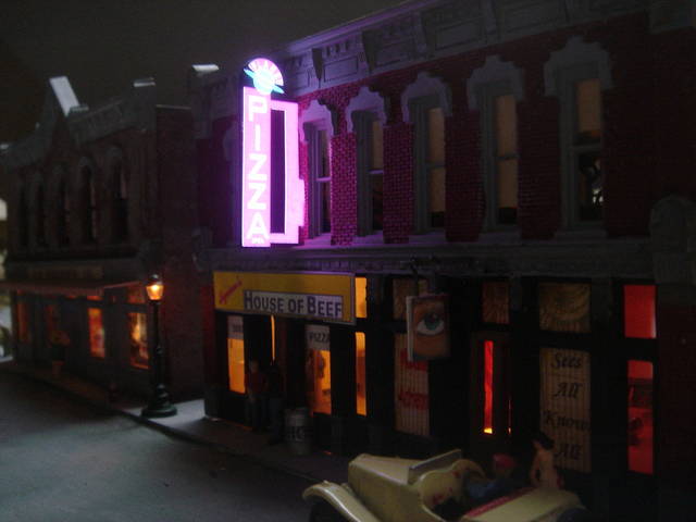

These are a couple of older Miller signs. They have been discontinued, which is a shame. The large animated signs are great, but these smaller ones fit into downtown streets without dominating the scene. This pizza parlor was done with a pair of signs, one left and one right, mounted at a slight angle to each other. I cut a slot into the building for each of them.
