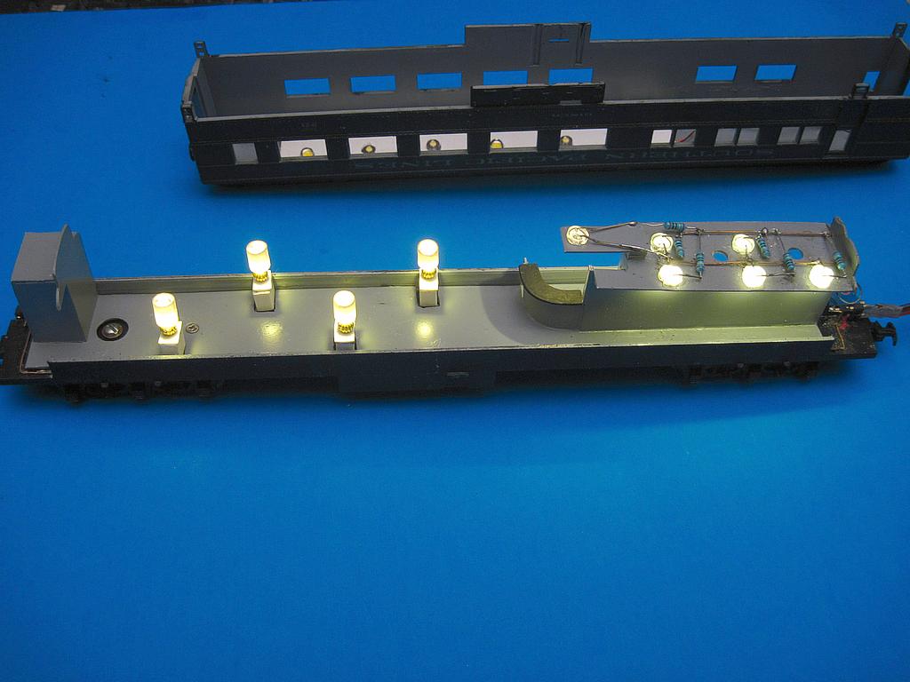

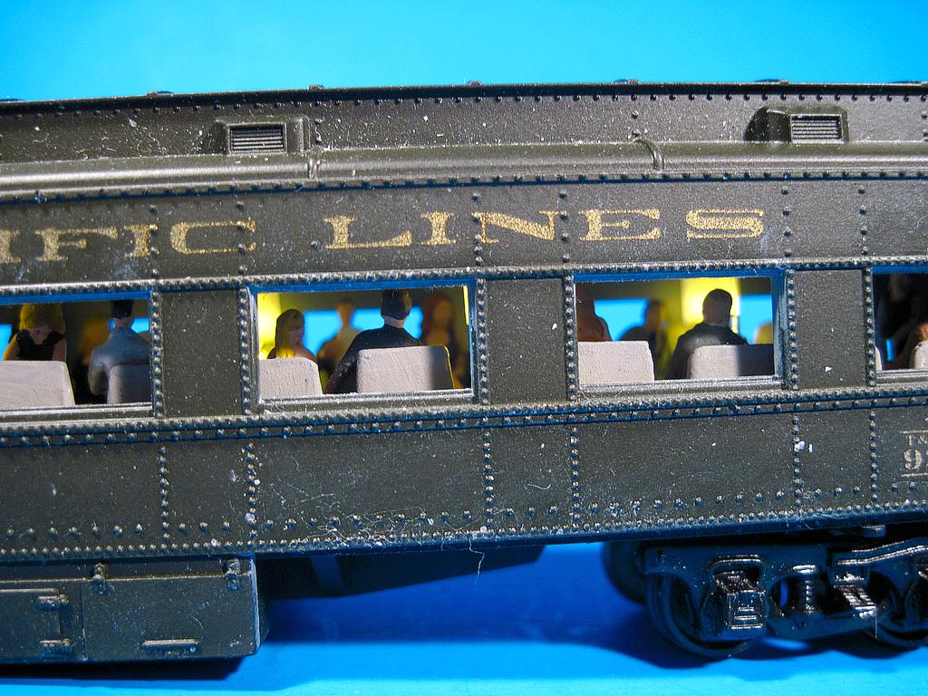

I’m not into brass passenger cars but I am into building interiors. I know that it’s very hard to see into an HO passenger car especially when it’s moving and at a distance but, it gives me a lot of satisfaction that I built them with the tiny people populating each car.
I do Athearn 72’ cars because longer cars don’t look right on my small layout and they are easy to kitbash.
Close up not moving the interiors do show up pretty good.
To date I have populated 11 Athearn Streamlined cars and 12 Athearn Heavyweight cars.
Even at a distance you can tell they have full interiors.
My 13th kitbash Heavyweight car (lounge car above) currently in progress on my workbench. At almost 84 years old I just love doing interiors.
