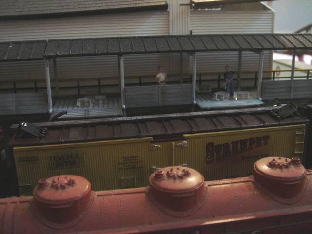

This is a close-up of the platform on my Walthers Cornerstone kit:
The ramps from the platform are all on hinge pins, so they can be placed in any position. The kit comes with the ice blocks, but not the figures shown here. I just threw this on the layout for the picture, by the way. I hadn’t finished the roof yet, and that’s why it appears to be coming apart at the seams.
The structure itself is a very large wood building. It’s pretty plain. Mine came in stark raving white, and I found the whole kit needed a lot of painting and weathering to make it look realistic. I guess I really wasn’t prepared for the overall size of the building itself.
