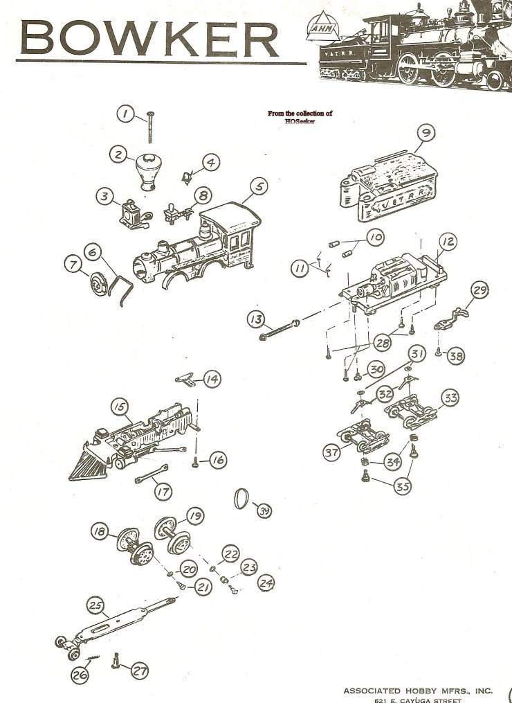

Look here
Be aware that the Bowker in common with other old AHM engines went through several design phases and parts are not always interchangable. if all else fails I might have a junker sitting around in some box but I’d need a better description of the part.
For example, the old AHM parts catalog on HO Seeker shows a tender drive
http://www.hoseeker.net/AHMRivarossiassembly/ahm240bowkerpg1.jpg
But my two engines (don’t ask!) had or have the motor in the cab – that is an example of what I am talking about.
If you have tender drive and are missing that connection between tender and locomotive, it might be possible to craft one out of styrene rod and some other parts.
