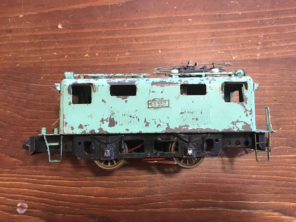

Here’s the images from the auction for the locomotive, by the way. Unfortunately, a restoration seems neccesary- I’m going to need to fix many solder joints as well as solder in replacements for missing details, which is going to ruin the remaining paint. I will do my best to match the original color, since I’m quite fond of it. It seems that the EB557 came in a wide variety of (largely non-prototypical) colors. The same applies to some other locomotives and most if not all of the rolling stock I’ve seen images of.
Note that despite the somewhat poor cosmetic condition, the most important pieces appear to all be present- both couplers are intact, the manual reverse switch appears to be intact, as does the center rail pickup shoe. The pantograph appears to be complete and intact, though perhaps slightly deformed. It doesn’t appear to be beyond repair. And of course, the spring belt is present and appears to be intact. Replacement pantographs seem to get expensive when someone lists a new replacement, but I don’t think I’ve see the spring belts come up for sale at all, so it was very important to me to make sure I got a locomotive where these two parts especially were present

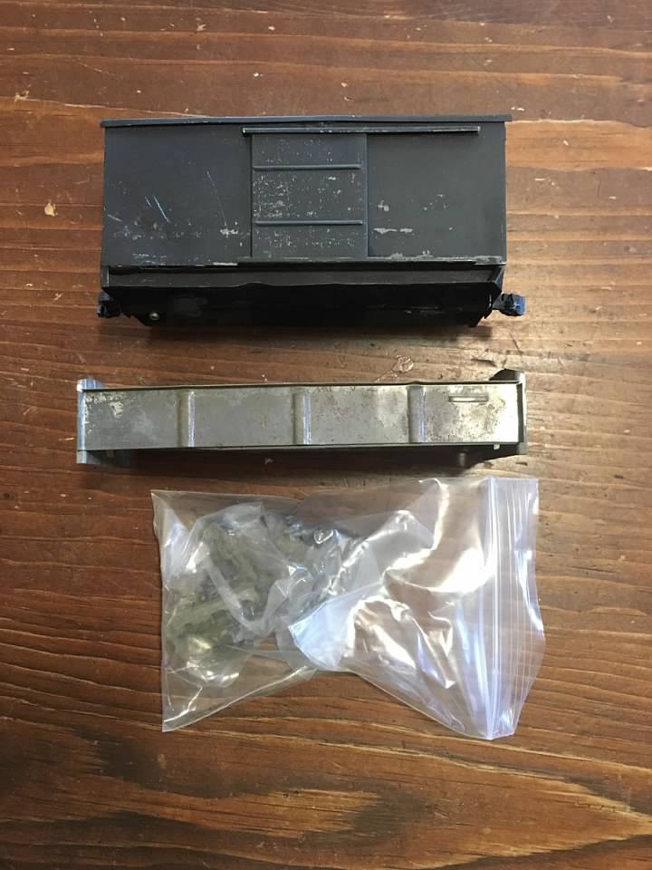

-A seperate boxcar body, gondola body, and 8 journal boxes/bearings. Only the boxcar has couplers, appears to have a very dull coat of paint. The gondola is unpainted and needs body work.

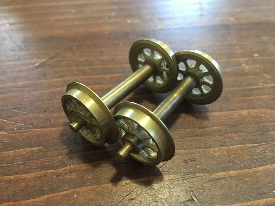

-A set of 2 similar, but possibly mismatched axles and corresponding wheels. The goal is to use these to repair the boxcar, with the gondola being a more “long term” potential project, if I can locate suitable wheels and couplers for it.

Ellie, looking at those wheels, axles, and spring hangers they look very, very similar to pre-war Lionel tinplate types.
New-made replacement parts for those Lionels are available from Henning’s Trains in Lansdale PA. www.henningstrains.com
Check their on-line parts catalog and see what you think. They may just work on your Japanese rolling stock if you need some.
I would have to disagree, I don’t think they’re all that similar to prewar Lionel. While also spoked, these are made of brass and have scale flanges and treads- My best bet is going to be procuring some non-spoked, scale brass wheelsets. They wouldn’t have to be brass to work but I’d prefer to at least have them match the originals in material if they can’t be the classic spoke wheels. The bearings/springs aren’t the same either, in that the Lionel ones are purely cosmetic trim whereas these are structural, they are the actual bearings for the axles and support the weight of the car. I should have all the ones I need (4 per car) so there’s nothing to worry about there. If I used Lionel trim parts I’d need to make my own bearings and supports, and then I’d solder the Lionel trim to the outside. That would be a lot of work though, so I’m content not needing to figure that one out.

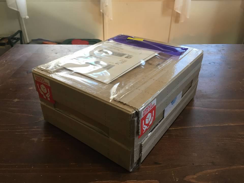

The monumental day has arrived! Yesterday, when I checked the tracking number on my package, it was in a sorting facility in CT. I didn’t want to get my hopes up, but it seemed possible that it could arrive the next day. I wake up this morning, check again, and by golly, it’s been delivered!
Now, on the one hand, perhaps purchasing the optional package reinforcement was a bit overkill…
…but on the other, well- I can tell you, that thing was absolutely SOLID. Granted I didn’t try it, but I almost believe I could have stood on it and it wouldn’t have crumpled. Again, very, very sturdy. It took me about 8 minutes to get all the reinforcement bracing off!
That said, once I got the bracing off of it, I found the package to still be quite sturdy (and it was well packed), so I probably won’t need to go for this option in future. It was still worth trying it out if only to see what the reinforcement is like.

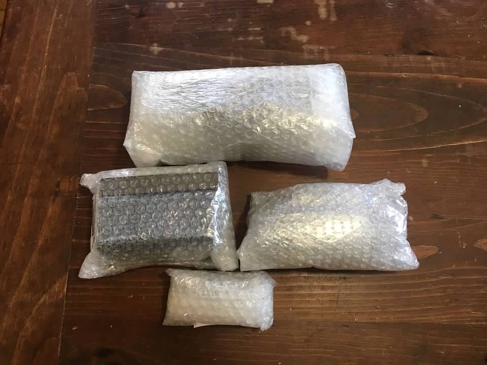

The contents of the package were snugly wrapped in multiple layers of bubble wrap, and additional bubble wrap was used to snug everything up inside so it couldn’t shift around inside. All in all, a very nice job, very consistent with what I hear from others about them (the proxy service I used).
It wasn’t hard to visually identify which item was in each wrapping.
I am happy to report that nothing seems to have incurred any injuries during transit. I need to do some work on everything I bought, but nothing unepected. The easiest task will be repairing the steps on the gondola/break van, one of which broke off wh
EB577 electric locomotive (manufcaturer unknown, either TER[Endo] or KTM [Katsumi]. Pantograph is marked KTM [Katsumi], the couplings have SA embossed on their brackets, the locomotive bears no other obvious maker’s marks.
Boxcar, gondola (manufacturer unknown, either TER or KTM). The boxcar’s couplings are embossed KTM, otherwise there are no maker’s markings on either car or the bearing castings. I suspect that they are Katsumi rather than TER but I could be off the mark.
Brass wheelsets (manufacturer unknown). No markings to indicate a manufacturer. They have the same diameter wheels, but the axles are different lengths. After comparing with the locomotive I bought, it would appear that the longer axle is for a locomotive. Why it is paired with such small diameter wheels (19mm) I have no clue. I am currently thinking about my options regarding making both wheelsets usable under the boxcar.
