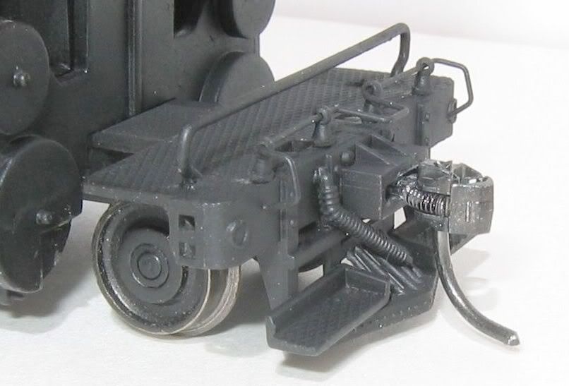

Here is photo of one of these semi-scale “whisker” Kadee’s installed in a Bachmann Spectrum 2-8-0. The Bachmann couple box is actually too shallow to accept the stock whisker coupler so I had to thin the shank a little.
