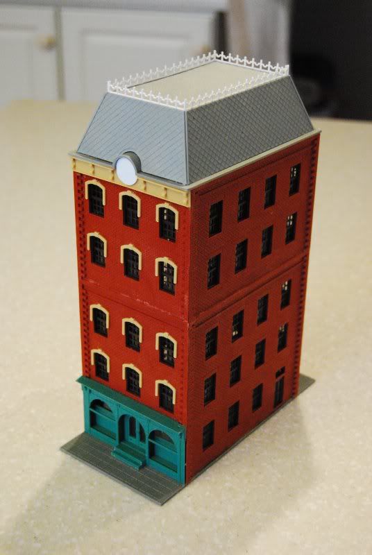

Here’s the five-story building i talked about.
I used two of the fire house models for this one plus a store front that I had in the scrap box from another project. It was pretty simple to cut the first floor off of one set of walls then carefully stack & glue them together. After that, assembly followed the normal path… add the windows, complete the walls, add the store front and the roof and the project was pretty much done.

I like mansard roof buildings, I have to build a 3 story one for my railroad’s headquarters.
Here are some tips for your next structure. When you combine walls vertically, measure the distance between the windows on the lower floors and then trim off walls on either the top or bottom section (or both) so that the windows at the joint have the same window spacing. That will make the building look more unified. If you just put one building on top of the other it can come out looking like you have two buildings stacked on top of each other rather than one tall building.
