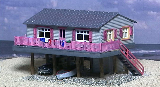

One of those common “ranch houses” raised as a beach house.

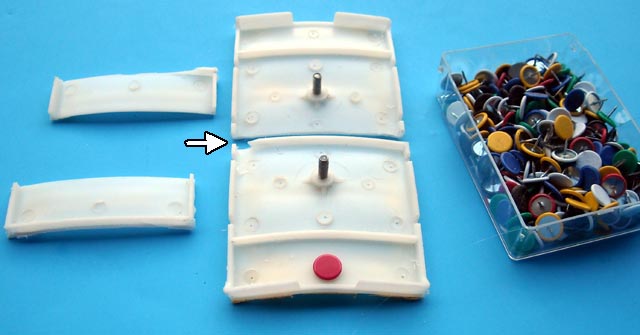

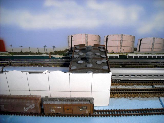

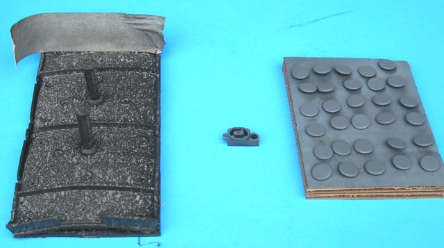

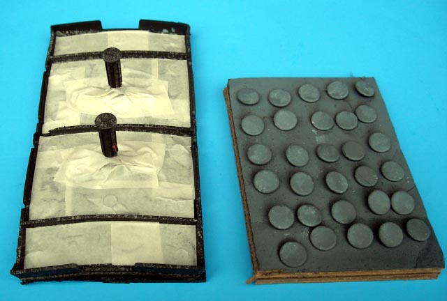

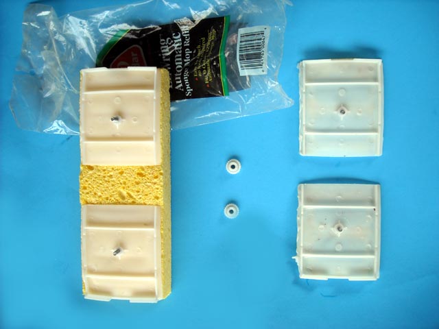

Mop head replacement parts “kitbashed” (?) into a barrel-vault roof for a dockside warehouse.
Roof and building front will hide passenger trains in layover staging.

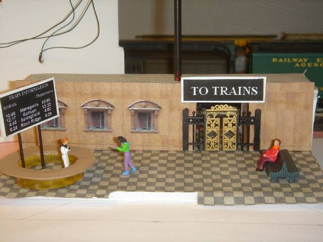

I was thinking of the Walthers “Union Station” kit, but that was much too large for the space I had. So, I took the Walthers YMCA, and shortened the side walls so it would fit. This is a large stone building with big windows, so it was easy to turn it into a station just by putting in an interior and some lights to show it off.

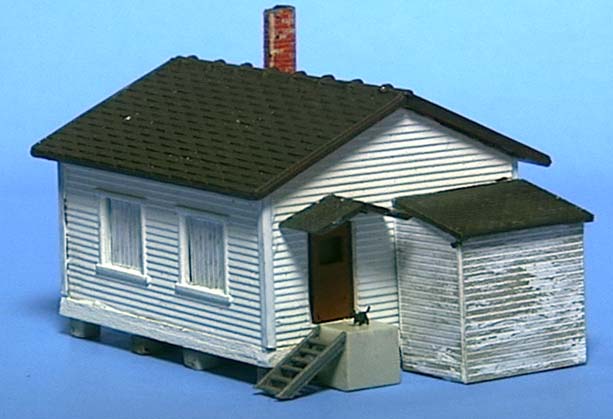

Here’s a few that I’ve hacked.
