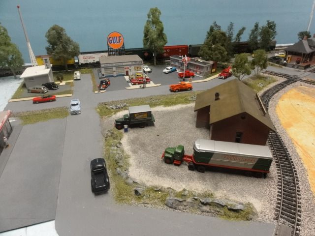

I just finished graveling the Freightways parking lot using WS fine light grey ballast around the edges and fine grey bkend with some fine grey on top.
First I “painted” the surface with a white glue / alcohol solution to hold the stone in place and then spread the stone. After spreading the stone I then wet it down with alcohol followed with the white glue mixture. The stone isn’t going anywhere, that’s for sure.
The light grey wasn’t quite as dark as I would have lilked so I may add more grey blend.
Let’s see some pictures and good luck.
