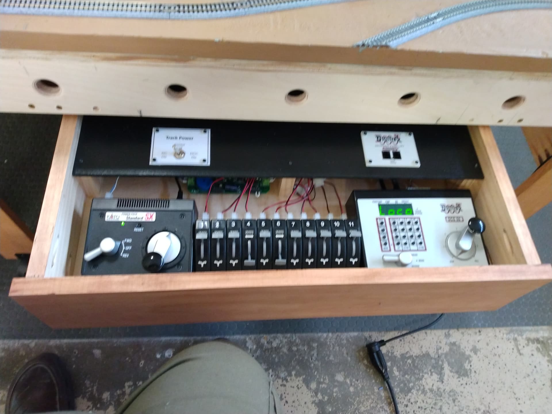

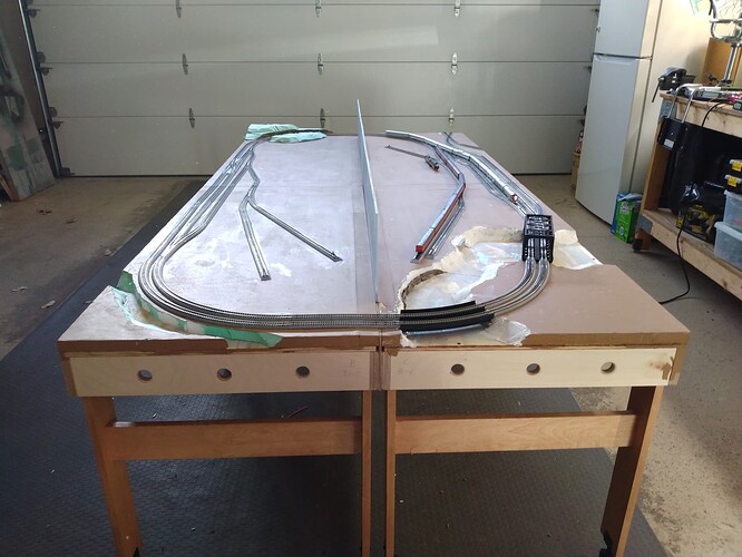

I designed a simple double track loop layout that consists of four 2’ by 4’ sections that fit together with clamps and aligning pins. There are also three spurs for industries and two short passing sidings in case I want to do some freight switching. Since I already have seven Kato passenger trains, I decided to go with Kato Unitrack. At the track joints between the sections, I remove the wings of the joiners to make it easier to connect the tracks. I have a drawer under one section with a Kato DC power supply and turnout controls and I am using an old Digitrax Zephyr DCS50 for DCC. There is a toggle switch that allows me to go between DC and DCC. And I have a Digitrax UR93 transceiver for a remote DT602D throttle.

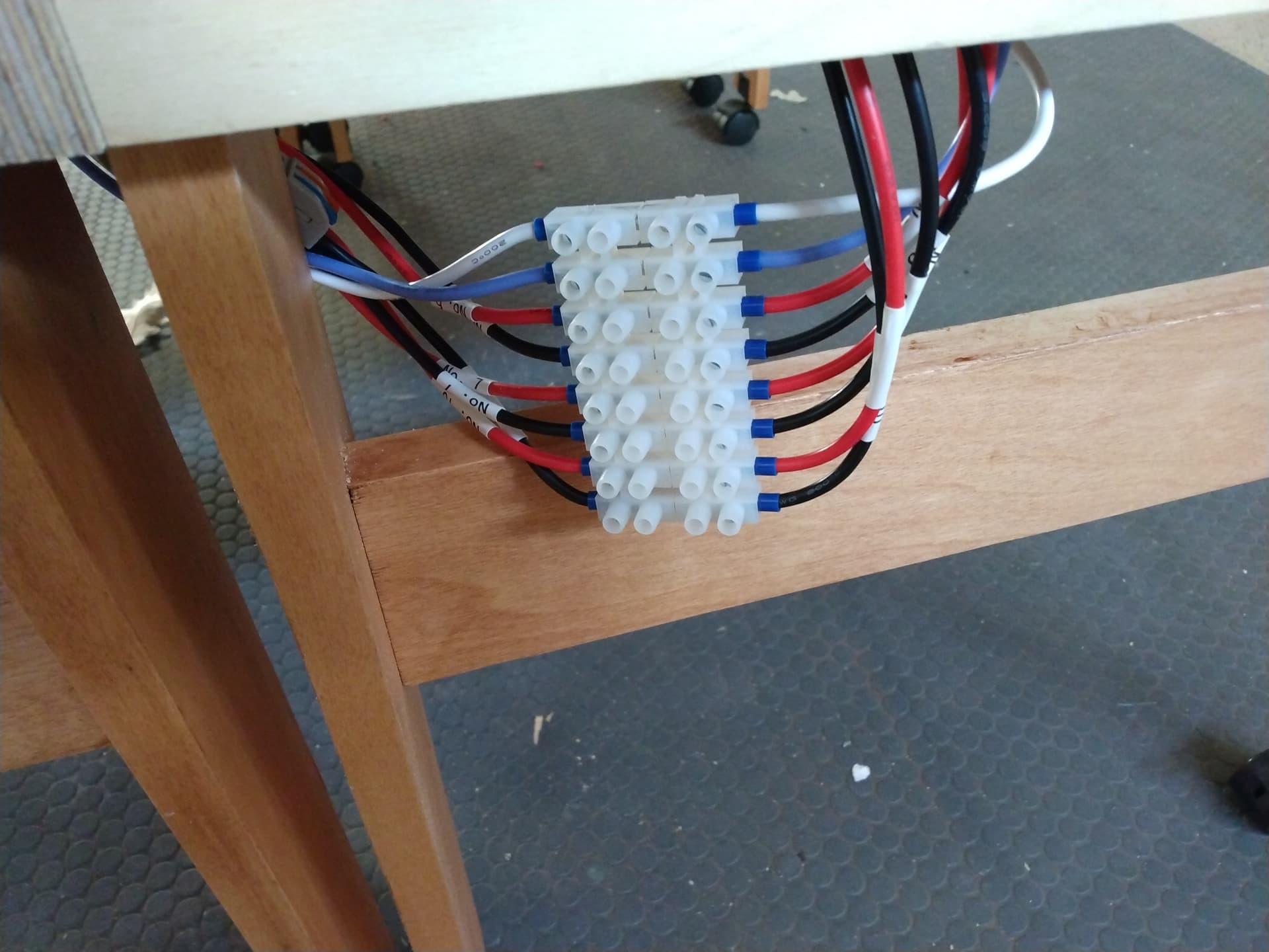

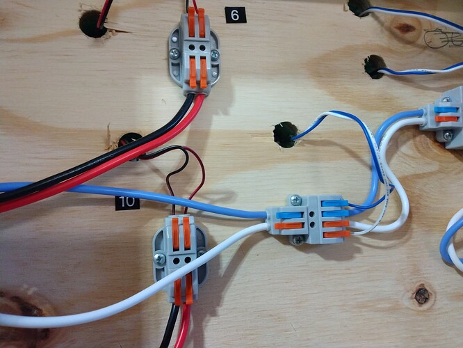

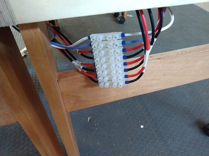

I have completed the wiring. I was using Anderson PowerPole connectors between the sections, but I have found them unreliable and switched to using European pluggable terminal blocks I have seen used by Charlie Bishop in England. For the drops I am not using suitcase connectors but GKEEMARS connectors (2 in 4 out). And I used GKEEMARS connectors for the turnout wiring (2 in 2 out). They are nice to work with and easier to work with than suitcase connectors. The fact that you can open the levers and remove a wire for troubleshooting is also nice.

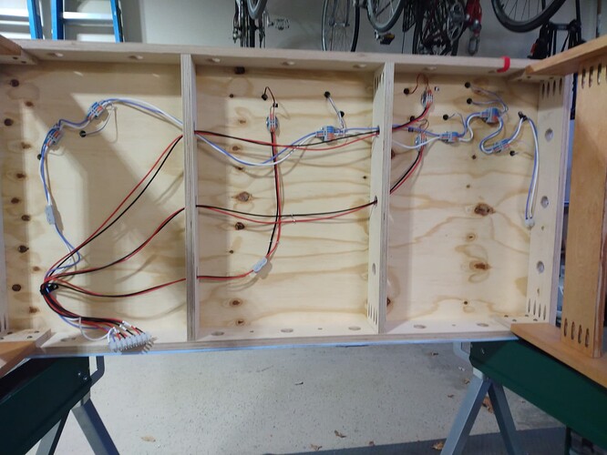

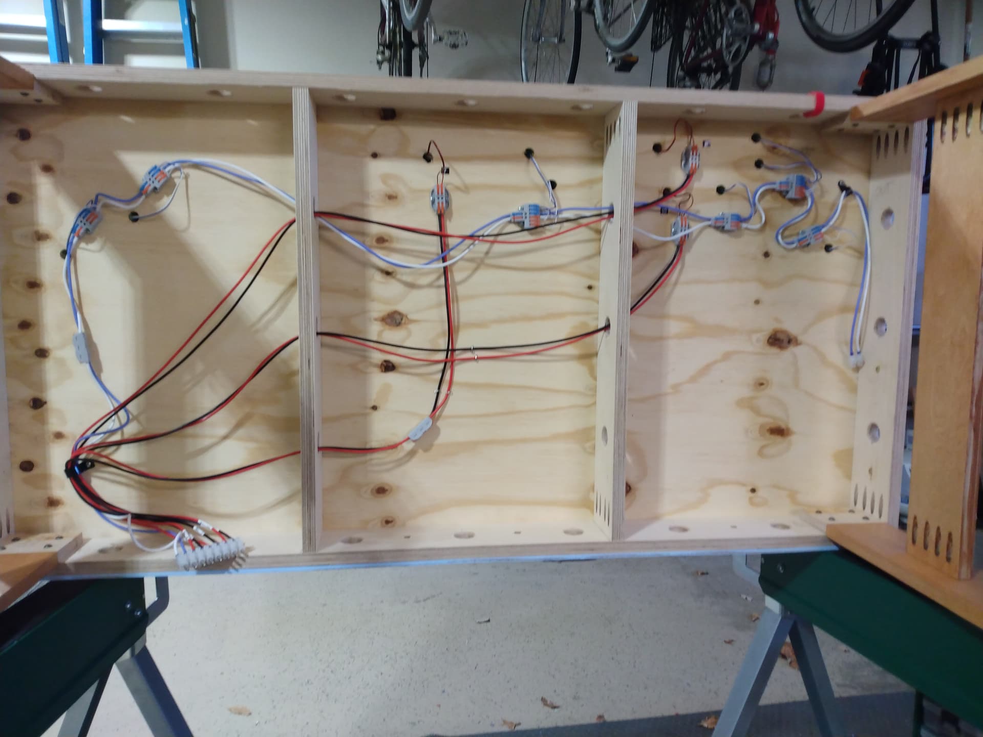

Section on sawhorses for easy wiring.
GKEEMARS connectors.
Control drawer with DC and DCC throttles.
Pluggable Terminal Blocks used between sections.
Four sections clamped together with a train running.

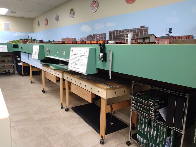

Four N sections stored under the HO layout.

Yet another comment. This N scale layout lets me correct things I do not like about my HO layout. I wish I had double tracked the HO layout, so the N layout is double tracked. My HO layout has mostly urban scenes and not a lot of spaces between places. The N scale layout is going to be rural based with only a few structures. Lastly, being able to tip the N sections over on sawhorses and do the wiring is fantastic compared to crawling under the HO layout to do wiring and troubleshooting.
