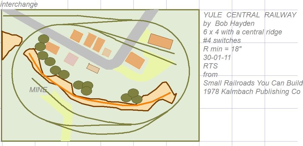

Hi Hugo,
an old time favourite: The Yule Central Railway by Bob Hayden
or with a slighty smaller radius:
