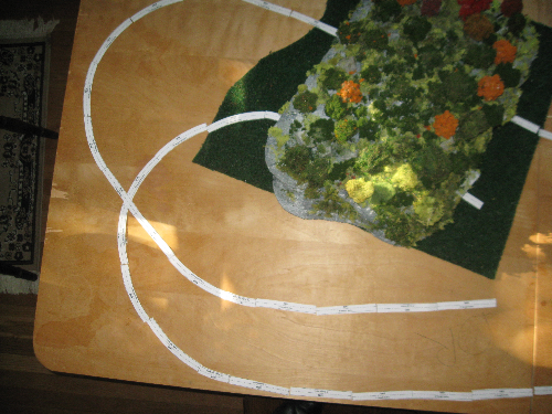

3X6 layout. Can trains negociate 180 degrees on the 3 foot width, using 11 and 9 3/4 radius curves?
Are there any passenger cars that will take these curves?

Hi Sid,
Maybe hard to use, but looking down at the bottom you will find Cat G and L are matching with your radii. Car or coach length should be limited to 60 feet prototypical length. If you are able to find passenger cars that short in N-scale is something else.
Running suburban coaches which are about 70 ft long require a 14,5 (about 15") radius. To large to fit in!
The table by the LDSIG is much more easy to use:

Hi!
I assume you are talking N scale here. If so, I would consider it similar to a 6x12 HO layout (I am much more experienced in HO/O as opposed to N).
In that regard, I would say that you could use most of the equipment you want (if not all) on that size layout - in N scale.
One thing you might consider is going to narrow gauge - either N or HO. The locos and equipment are generally much shorter and built for tighter radius curves. And, one can build a really interesting and detailed layout in narrow gauge in a small space.
