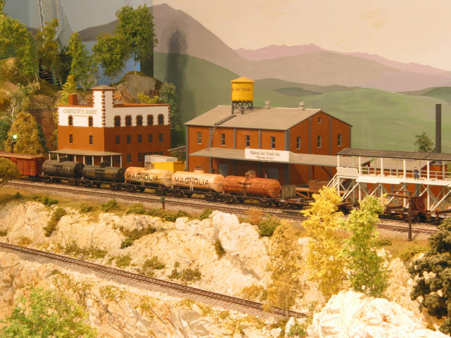

My last layout was built in an un-insulated garage here on the coast in CA. When I started my layout, I was in a big hurry to get something done. I had no idea that it would turn out as nice as it did. I then had to try to retrofit the garage: seal up the gaps in the doors, sheet rock the walls and finish the ceiling around a nicely detailed, pretty much completed layout. This was a difficult feat to accomplish with damaging the layout.
My advice up front would be to build an insulated layout room in your garage. This is what I did after I tore out the last layout. I took up most of the garage and left an aisle to put the washer and dryer along with tons of shelves. We permanently sealed the front door and sheet rocked the interior of the room. I took the opportunity to upgrade the electrical as well.
The room is 13’ X 22’ with a 6’ X 22’ aisle outside the room. There is a loft on top where we have more storage. It was a monumental “space grab” and one that my wife graciously accepts (bless her soul) as we live in a small house with little storage space.
The old layout in the garage had big problems with dust and the temperature swings (even on the temperate central coast) were enough to tweak track and make the space unpleasant to spend time in during the winter. I would take the time now to try and make your space as habitable as possible before cutting the first stick of bench work.
This photo shows the old layout. Notice the garage door spring arm in the upper left hand corner. Dust and cold air leaked in around the edge of the door in this area.
[url=http://www.trainboard.com/railimages/showphoto.php/photo/86018
