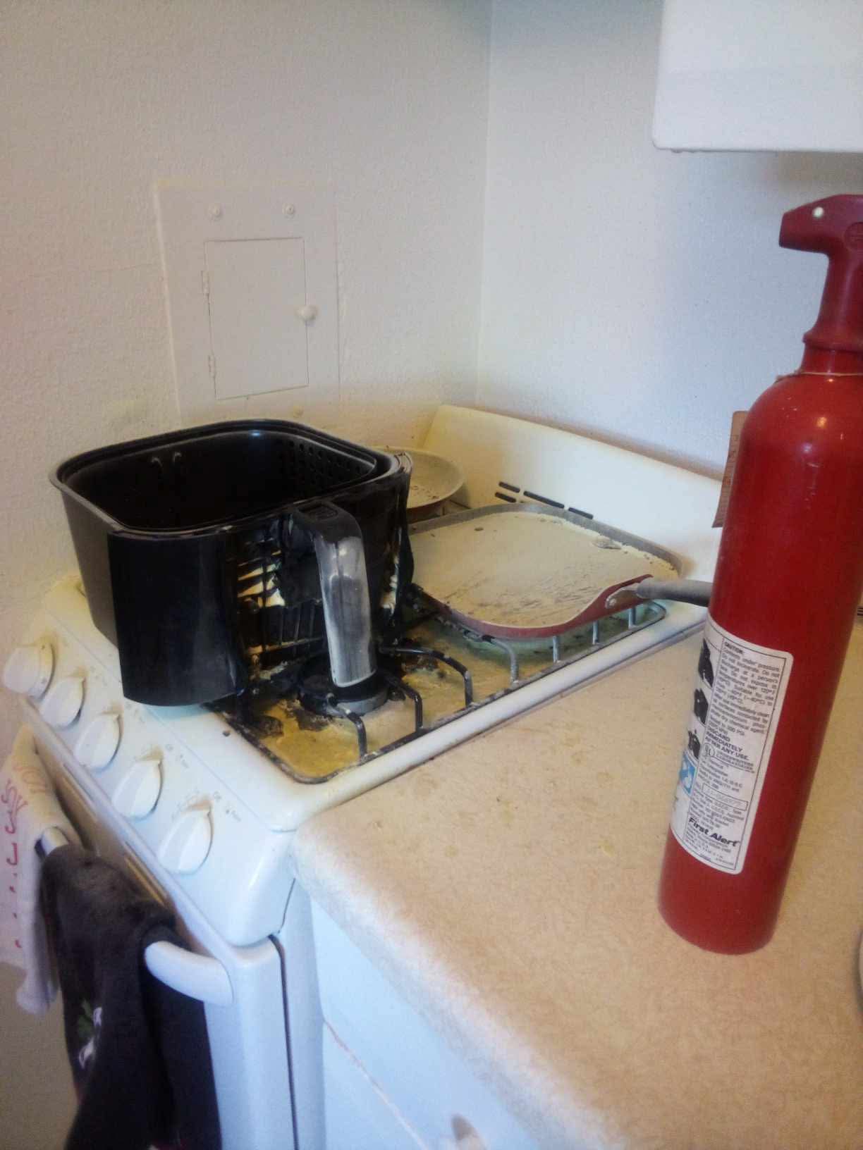

I had an air fryer basket that was cooling on top of a not recently used stove grate spontaneously combust while I was eating in the other room.
I wasn’t sure it would work since it was more than 30 years old but that old, dusty, Kidde ABC did exactly what it was supposed to do. I don’t know if it would work again since it had been partially discharged but there’s a great big extinguisher outside my apartment door if it doesn’t. Hopefully I’ll never need to find out :folded_hands:
