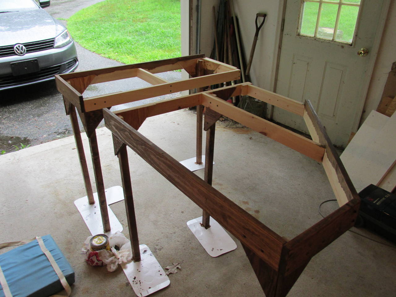

I, too, use gussets at the top of my layout legs. And, I’m using 2x2 lumber. Yeah, every board at Home Depot isn’t perfect, but it’s easy enough to find the ones that are.
The two layout sections are getting their stain and polyurethane in the garage before being disassembled and carried up to the train room. By finishing the wood, it seals it and reduces possible warping from humidity, and makes it look a lot nicer.
