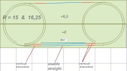

hi Mike
i am worried about the concept of your plan.
If it is like this you are building lots of grades without getting much from it. It seems to me you think it would be nice to have two levels, it might be nice to have them 6,5" apart; but what do you want to achieve? Beside you mentioning some scenery I have no clue.
Your math is right, with 2,5 " clearance and and a 15" min radius for your curves the resulting grade will be 2,7 %. Add 20/15 = 1,3 extra for the curves and the result will be a grade that would be 4% in comparison when build on a straight. According to literature short trains or extra engines are required. You are prepared to do both so no problems will arise in this area.
Due to much needed vertical transitions the usable length for stations is very short. Unless you are up to building very steep mountains the scenery on the lower level will be problematic.
The 2% advise from other posters is wise, though they should have added a remark. Generally speaking it makes a hell of a difference what you are up too. Short or long grades, short or long trains, how sharp are your curves, adding extra power and engines that perform quite differently.
BTW most derailments occur going downwards, it is definitely not the easy way.
Keep smiling
Paul

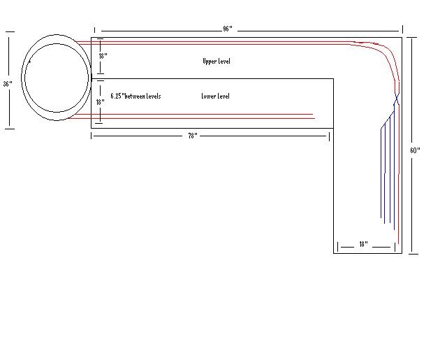

I am going to try and attach a plan with this post to better demonstraight my layout
Just an quick update, I have sucsesfully built a working helix. I want to thank everyone for all the advice on this. My trains run up and down with no issues at all. It took me about 4 hours but was defantly well worth it
Again thanks to all for the input on this.
