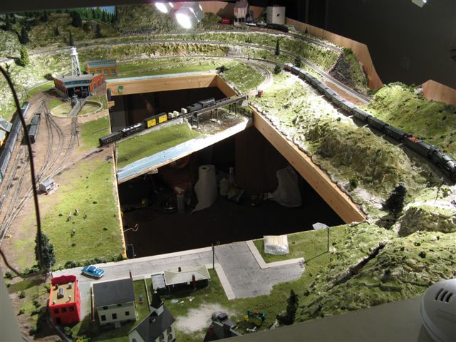

I love my duck-under to a central operating pit. I hate how low it is now on six years. I would do it again, but it would have to be more like a nod-under. I have left too much skin under the duck-under entrance at right and under that diagonal bridge that completes my reversing loop. Once inside, the scenery is wonderful.
Crandell
