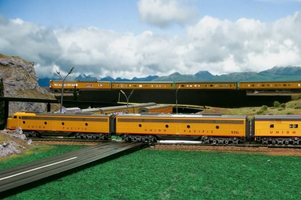

Got the CFL bulbs you mentioned. I avoid looking directly at them; they are pretty intense.
The first pic was with 1 bulb, bounced off the ceiling, overhead. There were no global adjustments (intensity, balance, etc.) done to the original images used in assembling this picture. No other lighting on the scene.
Both bulbs I got seemed to yield the same color balance. Unfortunately, they do not match my passenger car interior LED lighting when I get in tight for that. It’s close, but I get a slight blue-ish color in the interior. Can’t adjust the global color balance cause then the exterior gets to greenish. The site you linked listed the bulbs as 5000k.
This second pic yielded the same blue-ish imbalance in the orignal shot, but my LED room lamp was on at that time. I corrected the color balance slightly before cutting in the background image.
