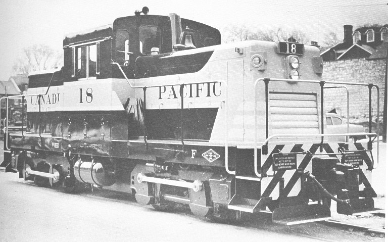

Some Diesels had the sand boxes located on the trucks.
As here GMD1. Scroll Down to CN 1912 in Green/Yellow.

CLC DT2. Sand Boxes by Steps.
