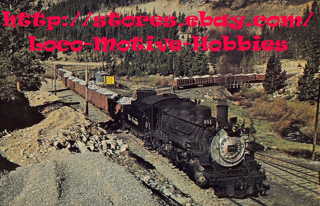

On the D&RGW, many long trains of limestone were always hauled in open, wood sided gondolas. The ore, on average, was mostly cobble size. (between 6x6x6 or 8x8x8)
This limestone was mostly out of the Monarch branch on the narrow gauge.
