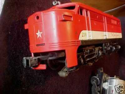

How can the broken / missing front pilot on a Lionel 210 be repaired? The lower right portion is missing completely. About half of the lower part is gone. Thanks.
Not exactly knowledgeable on that engine but if you call Jeff at the train tender he probably can tell you how to and what you need and have it for you. At a fair price.
Here’s a picture.210 pilot missing
Okay 1st Jeff has the part to repair the apron you will have to paint it thou. second It appears a piece to hold coupler is missing but thats all nI can see But if you call jeff he will be able to help you and you may want to take cover off engine and take a pic and he may have you send it to him.
The parts you want are # 204-78:
