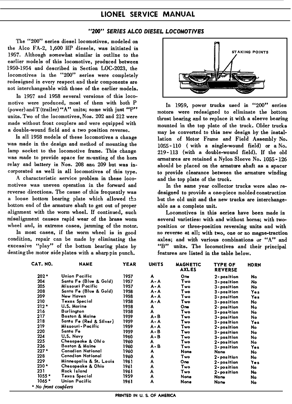

The problem you describe is caused by the the plastic bearing plate on the bottom of the motor (between the wheels) being loose. If you turn the loco upsidedown while the motor is binding, you can use your finger to press the plate from side to side. You will find that with the plate held to one side it will run well, and when pressed to the other side it will run even worse than when you don’t touch the plate.
Lionel recommended using a sharp, pointy punch to dimple the aluminum side of the motor frame to push the plate in the proper direction. I have fixed the problem by slipping a paper matchstick on the appropriate side.

CWBURFLE nailed it down right.
The problem is the lower bearing plate is floating in the stamped aluminum motor side frames as the factory staking has worked loose over the years. This will cause the armature to hop violently and the brushes to jump around in their holders.
The old Lionel fix for this was to “dent” the side frames with a punch, some shops used cardstock jammed in to firm up the plate.
I have had good luck using tiny black anodized self-tapping screws into drilled pilot holes to hold the bearing in place.
For a non-destructive fix, my latest method, though, beats them all. Using the CRC QD or any non-residue contact cleaner, clean ALL oil & residue from between the sideframes & the bearing, using the nozzle to spray into the crevice. Dry it out well, several hours or overnight with a light airflow.
Now use the regular “thin”(not gel) CA adhesive(“Super Glue”, Eastman 910, etc.) and flow the cement into the crevice on both sides, letting it creep in by capillary action to fill the gap.
In about 10 minutes, the loco is ready to be lubed(grease on gears, oil on pivots & bearings/axles - don’t forget to grease the lower armature bushing below the worm) and will run like new.
