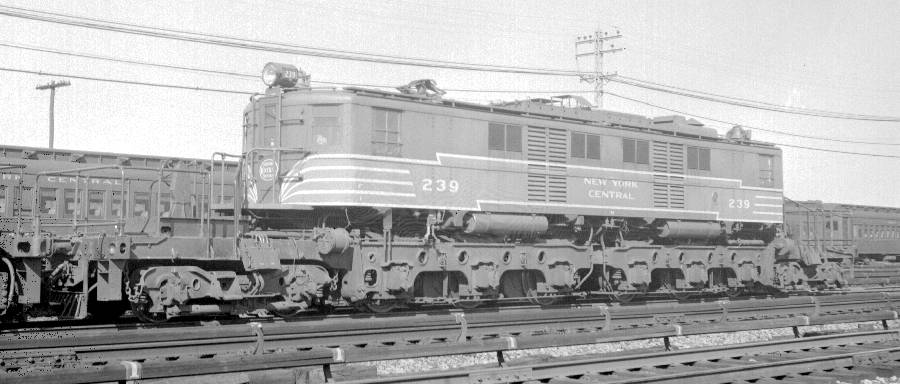

It’s not a New Haven loco at all. It’s based on the New York Central “T-Motor”:
It’s the smaller brother to the P2 Motors:
…which were ex-Cleveland Union Terminal P1a’s:

Becky certainly hit all the high points, and there’s little I can add except you have to remember Lionel’s pre-war locomotives and trains are very loose interpretations of the real thing. They were meant to be toys after all, and not scale models.
Those would come later with the Hiawatha, the M-10000, and the 700E Hudson.
For example, the Standard Gauge Blue Comet doesn’t look anything at all like the real train. But it sure is cool!

I know they are loose interpertations, but the electrics often share quite notable traits with real locos, wheras the steamers aren’t based off of any prototype as far as I know (but I’m ready to be proven wrong!). Thanks, that sure looks like what the 8e is representing! For some reason I thought New Haven. Of course, the 256 was based on a New Haven boxcab. Shame they never had a standard gauge equivalent, that would’ve been neat! Judging by what you say, sounds like my loco was made roughly between 1927 and 1928, but easily could have been made a year or two beyond this bracket. It has cast headlights, thus the 1927 date, and transition couplers are c. 1923 to 1928, according to the info above, but it stands to reason that I can’t be sure of dates. Hey, that’s a 2-3 year margin, I’m glad to be that close. I’m quite confident that the parts are original, the headlights are not repros, and have zinc pest. The couplings had black paint on them, and the frame had clearly been repainted. Stands to reason that the prior owner didn’t have the ability, or confidence, to remove the couplers. Sloppy paintwork too! the loco of course, has the 2 position E unit.
