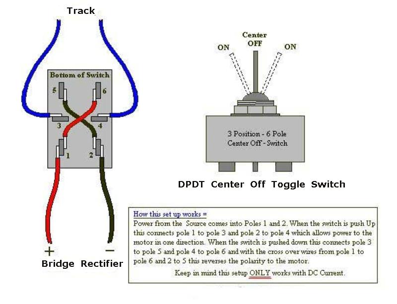

You should be able to wire in a 5 amp or larger fullwave bridge rectifier and use the Lionel throttle to control the speed of HO scale DC only locomotives. A Caution about using it at full throttle as the CW 80 is 18 volt AC and even with the 1.4 volt drop through the bridge the voltage will be considerably higher than the 12 volt nominal HO operating voltage.
The two ~ terminals on the bridge go to the CW 80 and the +,- go to the rails.
Mel

Ed is correct, I forgot a reversing switch.
You will need a three position DPDT Center Off Toggle switch to reverse your trains. That would be On-Off-On or Forward Off Reverse.
Mel
