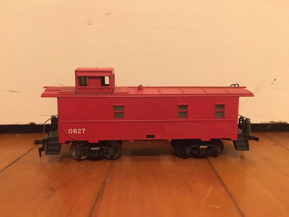

There are certainly obvious examples of rebranded equipment- the 0272 New Haven is clearly a stock Athearn rubber band drive F unit. The Lionel HO cabooses are dead ringers for cars made by Roco*. The interior of the 0827 illuminated caboose features a socket and bulb that scream ‘Lionel’ which inclines me to think that Roco supplied Lionel with the tooling or just the plastic components, and Lionel decorated and assembled them. I don’t know, this is all just my own speculation.
