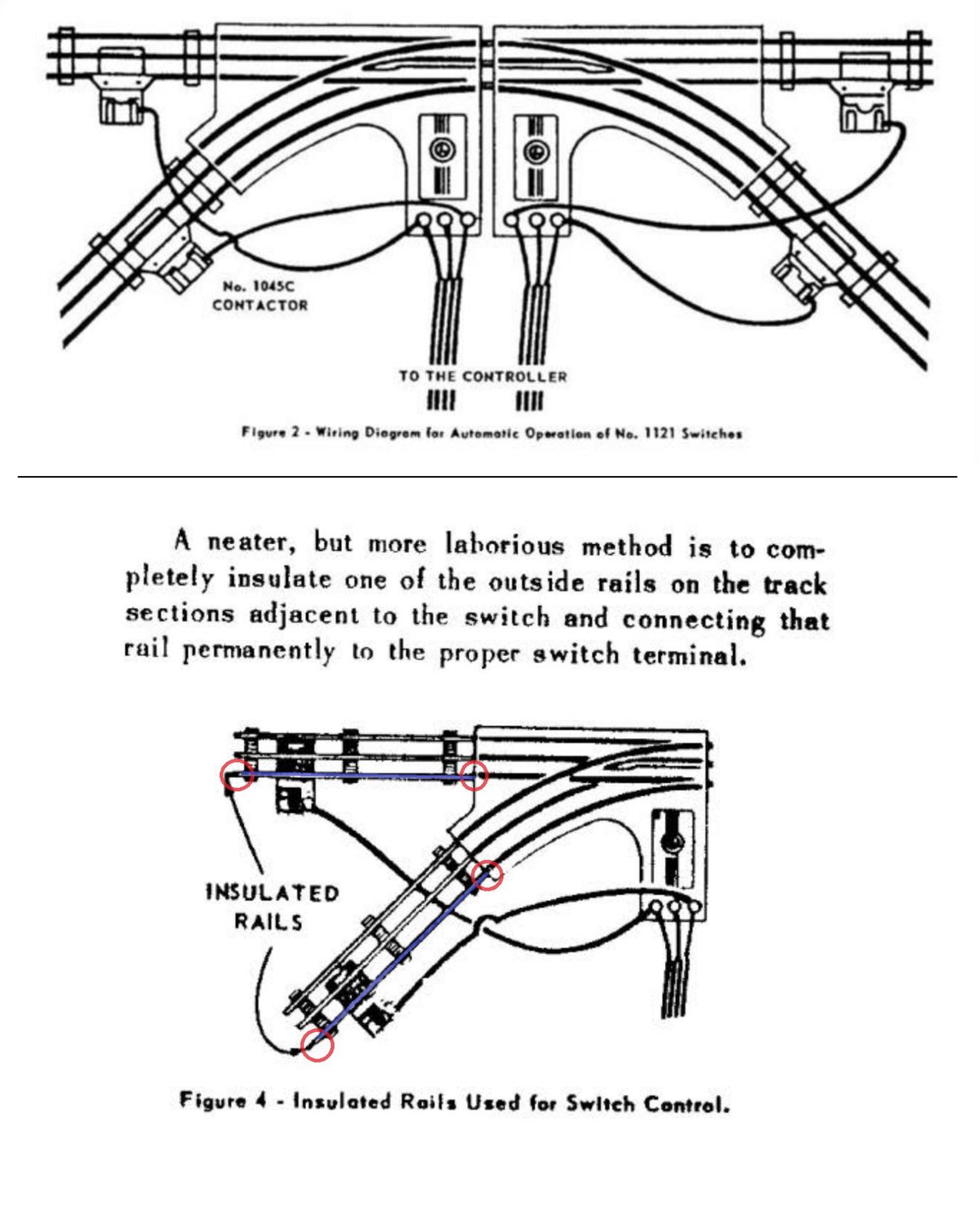

The non-derailing is a whole 'nuther problem, but it can be done in the same fashion as with the 1121 O-27 switches:

Update on the 711 turnouts The great news: while removing the rusty pins from the 711 turnouts, I put fibre pins in the outside rails and ran my 2245 Texas speciaL and purpusly set the turnouts against the f3 and to my surprise the turnouts threw back in the correct position! The nit so great news: The nonderailing feature on one of the 711 turnouts won’t respond on one of the Two directions set against the f3. I tried other postwar locos including my 221 streamlined Hudson, 224 and 675, 2037, 2055 Santa Fe Hudson, 726rr Berkshire and 624 chessapeake & ohio switcher all derailed as well trying my prewar locos 265e, 150, 249e, and 262e all derailed on that one side i thought maybe the prewar locos would have had better luck but the nonnderail wouldn’t activate. The bad news: the same turnout with the nonderailing feature not working on the straight part of the turnout it’s motor box center terminal post is now loose.
