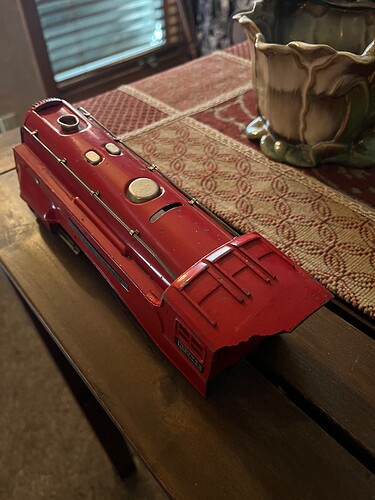

Second question is regarding any methods for repairing the broken pot metal on the locomotive roof. I was think two options, body filler like bondo and repaint to match or using cut off wheel to round out the Cab Roof. Not looking for a show piece but want it to appear somewhat better than it is. Any suggestions on either question is appreciated. Richar

Per the broken cab roof my inclination would be to cut a piece of sheet metal to go over the trailing end of the cab roof, fill the broken area underneath with Bondo or other body puttys, then sand and paint.
