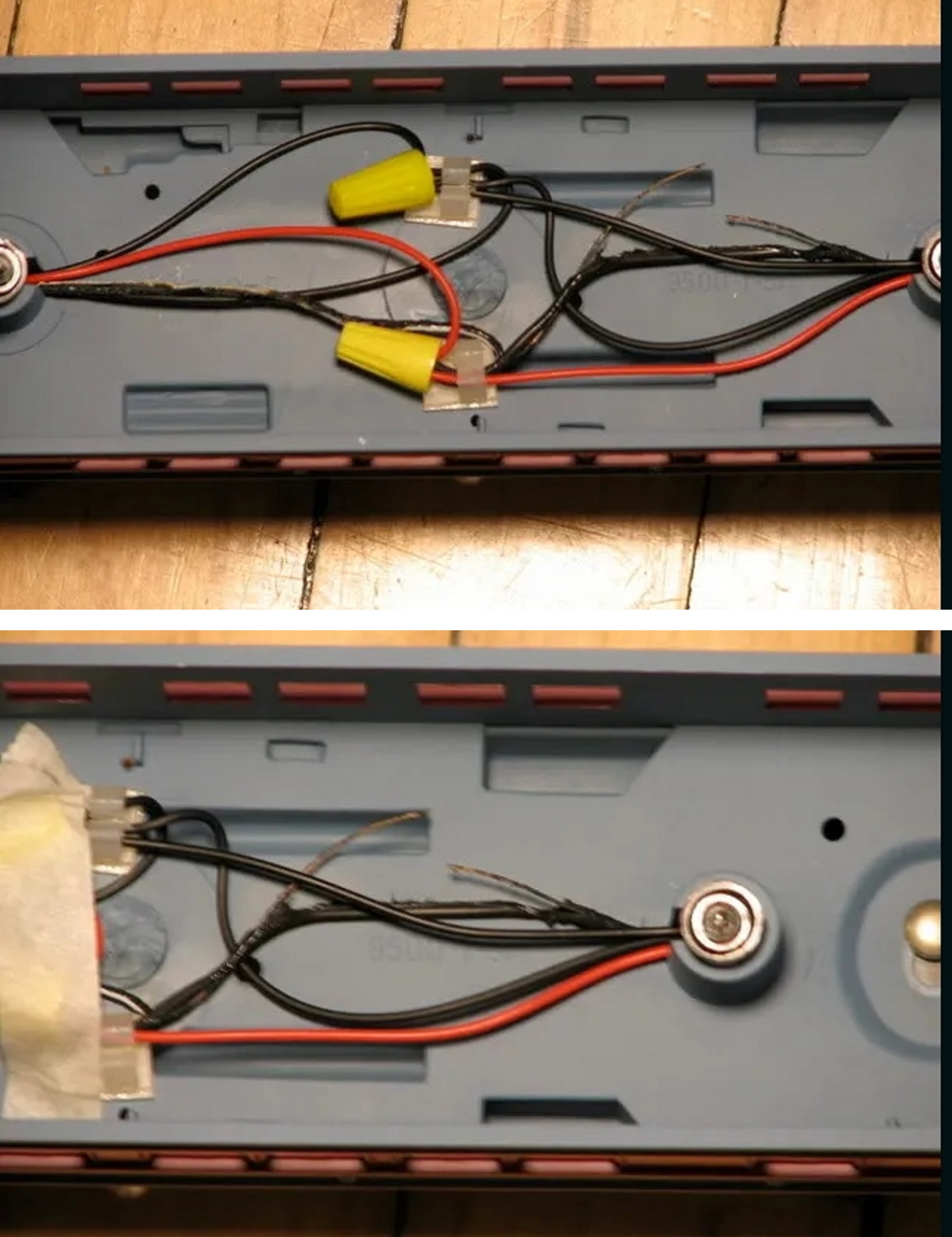

The real problem is damage to the transformer… the fault current I have measured is small, under 4-5 amps at a few volts difference, but quickly jumps to 20-30 amps at 6-7 volts difference in throttle settings. The Type V and Type Z transformers are quite powerful and have been known to burn through the secondary windings due to these fault currents.
Here is a PE car that had the two trucks straddling two power districts:
