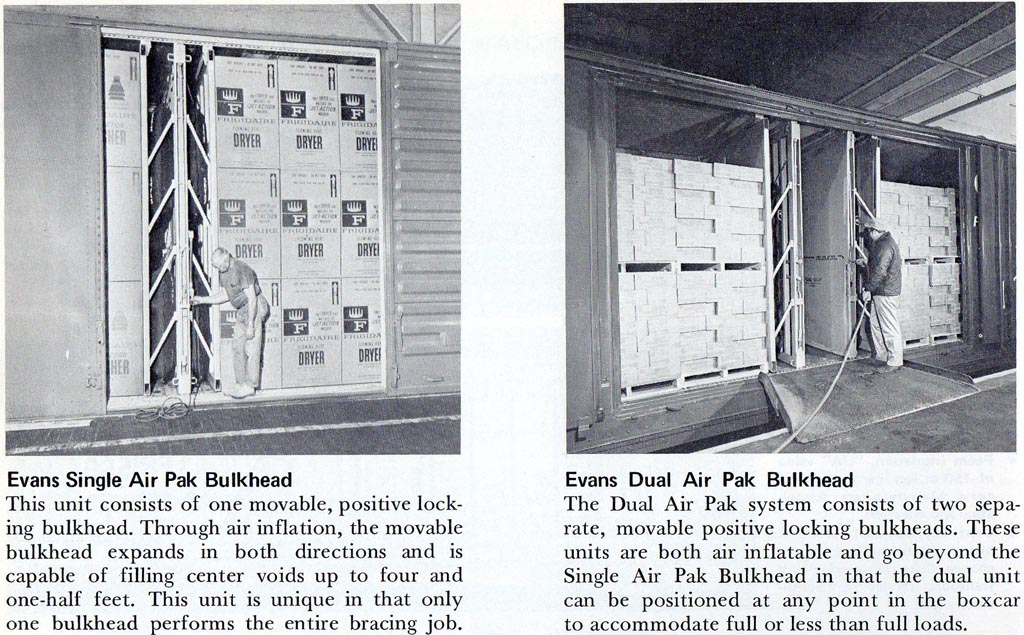

[Air Pak] is an Evans brand developed in the late 1960s, which increases the thickness of the movable bulkhead loading device by pneumatic pressure. There were “Single” and “Dual.” See a blog post of “TransPacific R.R.”

Evans Air Pak bulkhead loading device
Page S3-208 of the Car and Locomotive Cyclopedia 1974 edition
