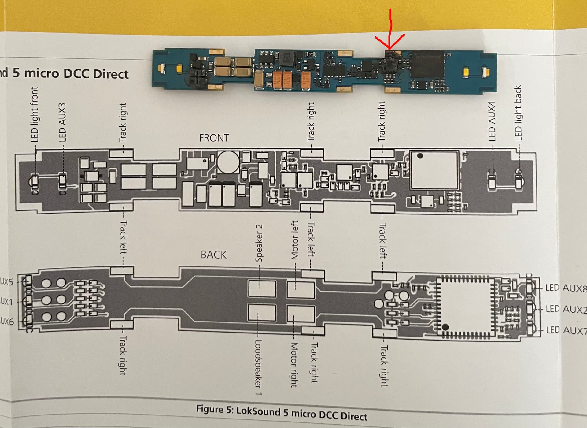

If it were a short, I’d think circuit breakers would trip. Do you have a picture of both sides of the deflicted decoder, and the socket it was installed in?

The place it fried is indicated by the arrow. I suppose it could have contacted the frame on the underside.
I wouldn’t be surprised if it wasn’t a short caused when you putting the engine on the track. It’s correct as noted earlier that you’d think that would have tripped the circuit breaker, but it might have only taken a split second - especially if as I mentioned earlier, the club layout uses a higher voltage DCC on their tracks.

It may be a “drop-in” install. However, is it possible that the underside of the board was shorting to the frame? I always check for clearance when installing decoders. If clearance is sketchy, I add a Kapton tape “shield” to that portion of the board.
