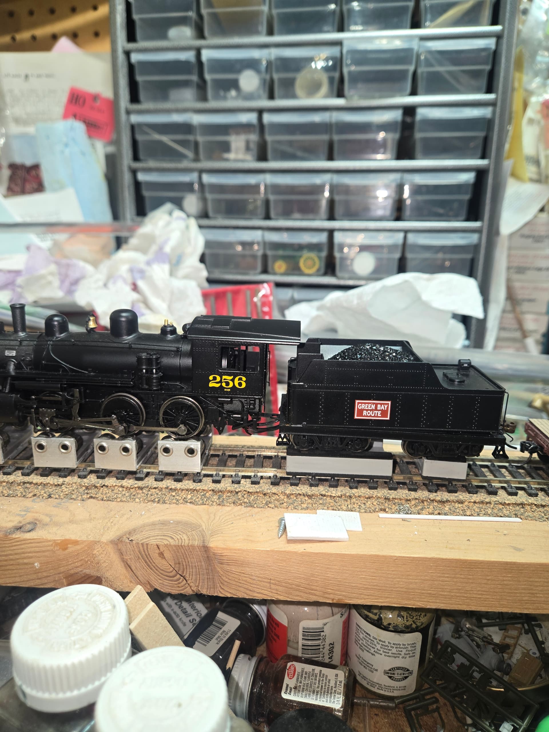

Here is the stock engine:
For some reason, Bachmann chose a prototype from a relatively obscure Midwestern line rather than a better known prototype. I never could get friendly with the appearance of this engine as it’s delivered. I found the headlight to be much too small, the tender is a goofy one of a kind prototype that I think it looks funny, the bell is an extremely crude casting, the Whistle is extremely undersized, and the Cab window is a single sheet of glass that would never last a day on a real Railroad.

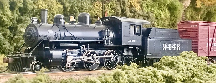

I fixed all of that on one of my engines and this is how it came out:
Much, much better!
The tender is one intended for the Bachmann tin Wheeler that may still be in the Bachmann Parts store. I bought three or four of them while I was at it because those things have a way of going away and never coming back. All of my engines are being converted to oil burners, and the bunker on that one is a spare part from a spectrum Richmond 4-4-0 back in the days when Bachmann actually did stuff like that.
