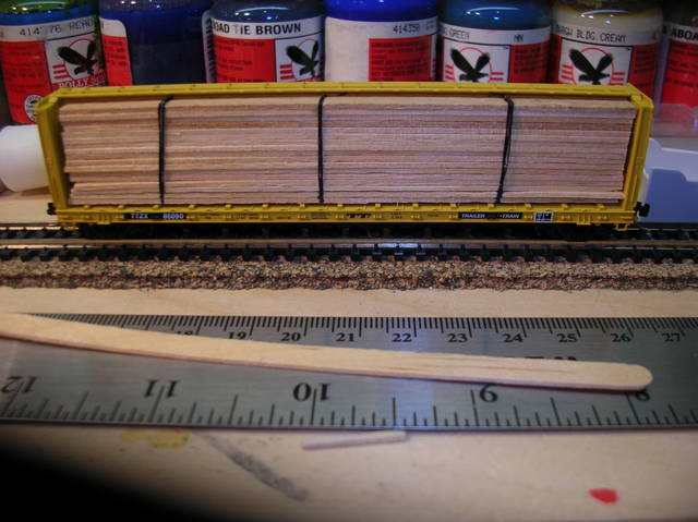

A few loads I did make that turned out great were unwrapped green (unseasoned) rough stock. I made this for McKean open centerbeams. I started with a piece of 3/8" thick clear pine and cut it to 1 3/8 high x 8" long. I ripped my strip wood to aproximate thickness and sliced the widths with an Xacto blade. The first coarse was divided up in 16, 12, 10s ans 8’ glued with Goo and then glued to the block. Once the first layer is completed the remaining stacks are just glued in place on the block. Remember to divide the height for even layers and also don’t forget the stickers (spacers) between the layers. The space between stacks was darkened on the block to give the apearance of greater depth rather than showing only one layer of facard on the outside. The top layer was l

For my N scale centerbeams - I took the really long /really thin coffee stir sticks and cut them with the ‘chopper’ into identical or close to lengths. I wood glued them in an appropriate height stack and wrapped a little thread around them. A quick clear coat, then a little blob of silicon to hold each side in place on the car.
The next bunch will be wrapped in - large address labels (for letters) - a famous paper companies’ logo repeated over and over which I printed with a colour printer. …Too much time on my hands I guess - but I couldn’t see myself paying all that money for pre-made one’s.

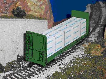

This might be the posting you are researching, I copied it to my files and saved it in a Word document back on May 16th of this year: (I do not remember who the original poster was, but thanks go out to the original poster!)
Lumber Loads Wrapped
I’ve wanted some lumber loads for my flat cars, but I just can’t stomach forking over ten or fifteen dollars for a single car load. So, I set out to make my own this week.
I completed my first lumber load this evening. It’s a Weyerhaeuser wrapped load of particle board, headed out to some city, somewhere. I’m very pleased with the end result!
To make this load, I stole the Weyerhaeuser logo off of the Internet, shrunk it and copied it several dozen times in Microsoft Word. I recopied that until I had a page full of lined up logos. I then printed out a sheet of logos on thick paper using the best quality color print setting.
The next step was to cut the paper to wrap around four glued-together sticks of square balsa wood. It doesn’t show in the photos, but there are some gently scribed horizontal lines to give the appearance of the product underneath. The tie-down bands were added with a felt tip pen and a small ruler.
How’s that for an evening’s craft project?
