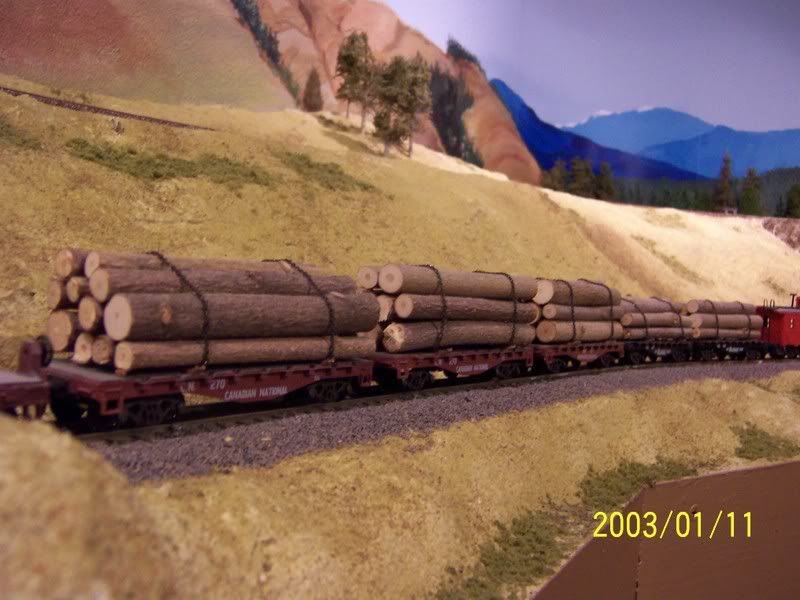

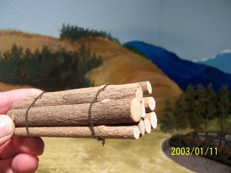

Mike Siggins used my technique to make those logs.
Visit:
http://www.pacificcoastairlinerr.com/logs/
Thank you if you visit
Harold

I used to get Southern White Pine (natural) Christmas Trees. Once their assignment as a Christmas tree was done and they had sat in the back yard for awhile, I would use my pruning shears and cut the small limbs into lengths equal to what my HO log cars could carry. A variety of diameters of “logs” were made in this way. These were stored in large zip-lock bags. The bark detail looks fine and they don’t seem to dry out - and it is surely easier than trying to make a dowel look like a log. I have had these for over five years and they still look good.
Bill
