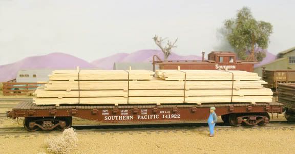

I’ve only ever seen wrapped lumber on centrebeam flats, but for bulkhead flats, regular flats, gondolas, and boxcars, you can easily build your own loads using scale lumber or painted styrene.
To keep the cost down, the loads are hollow:
Mine are all held in place by blocking and stakes, and are completely removeable. While they’ll fit the same manufacturer’s similar cars, they’re not interchangeable with most other manufacturers’ cars of the same types, due either to the stake spacing or to the width of the car. I mark my loads on their interior as to the particular car(s) which they’ll fit.
You can add weight to the loads, as I did for the modified Athearn car with the bulkheads, or glue magnets inside to help keep them in place, although I think that the stakes and blocking enhance the appearance.
