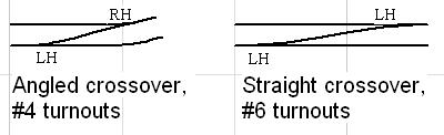

The are a couple of S-curves coming out of the loops into turnouts diverging in the opposite direction that will likely be problematic. Angled crossovers would help in a couple of cases, although they’re not very common on real-life railroads.
