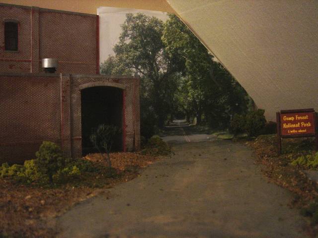

There was an article a few months back in MR about using a photo-backdrop to “extend” a road into the wall. The background of this scene is a picture of the street in front of my house.

This area is not finished but you get the idea from the photos below.
