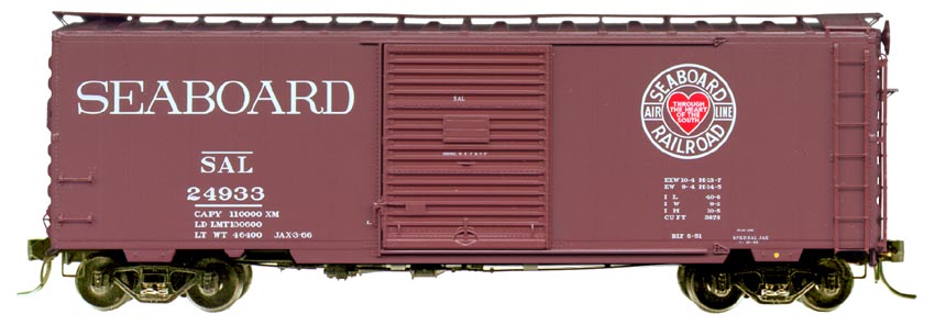

what I mean by “crisp” is high-resolution and clean, for example, here is a boxcar photo I just found on-line:
http://www.trainweb.org/seaboard/MODELS/kadee5112sal24933big.jpg
lets say you wanted to make decals from that lettering, here is full-size (more or less) text for G-gauge, that I made from that photograph:
notice its rather fuzzy…I had to blow it up (make it bigger) to make it the correct size for a G-scale boxcar…and its only 72ppi (pixels per inch) which is the resolution of virtually everything on the internet.
now…If I try to design the same lettering from scratch in photoshop, I get this!
The original (that I made from scratch) is 200ppi, and much “crisper”!
(the original is actually “crisper” than what can be displayed on a computer monitor!..so its actually “better than it looks” on this forum, if you follow…)
of course, matching the exact font style is harder when making lettering yourself,(if I poked around, I could probably find a font that matches better…and yes, you can buy specific “railroad” fonts that several places offer, like “Penn Central Font” or “Railroad Roman”) and im not good at making logos from scratch!
but generally speaking, for lettering, its always better to make them yourself…you dont n
