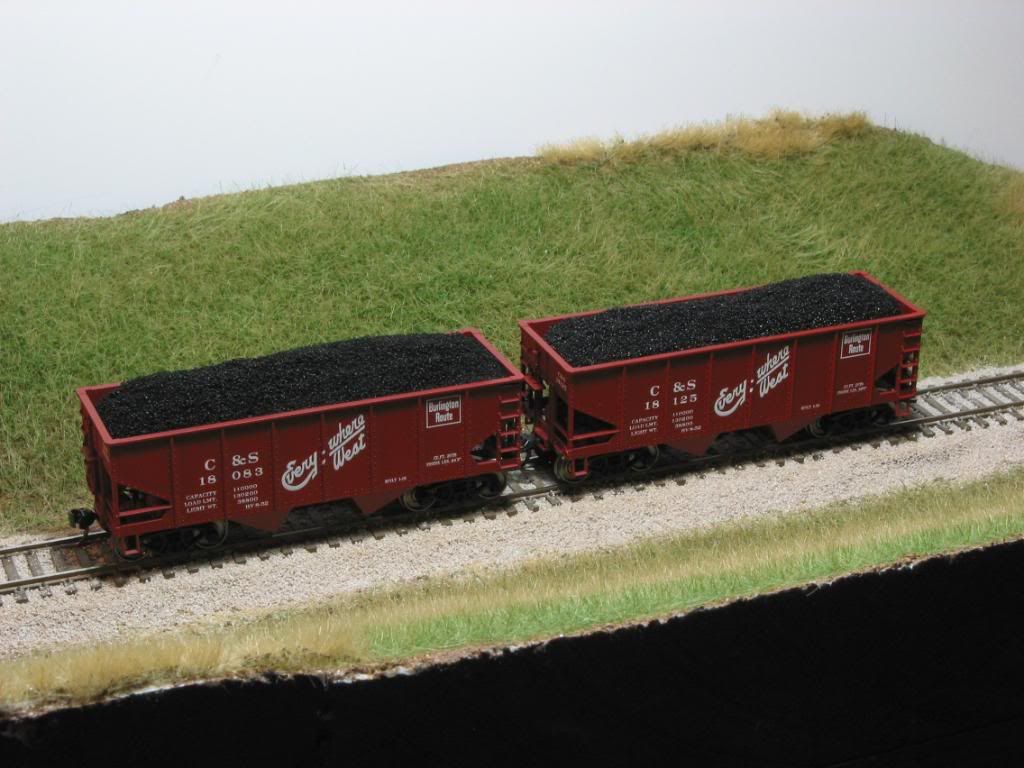

Here’s some coal loads to consider. Easy, cheap and fast to make.
I make my own. Cut a piece of soft pine to fit into the car. Then use anything (knife, plane, surform, wood rasp, drum sander, anything you like) to shape the wood into a rounded moundy pile-of-coal shape. Paint it black, cover it with Woodland Senics coal. Secure the coal with white glue.
