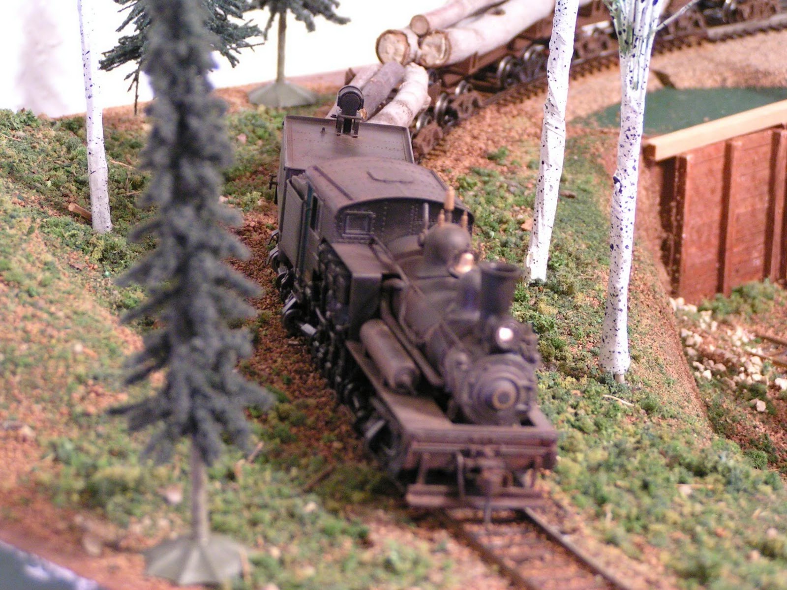

On the upper corner I made a small hill using newspapers and plaster cloth, and planted some trees, excuse the tree “foot”, it was later covered with ground material.
